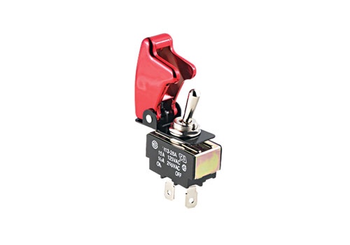

Looks kinda like a space shuttle switch. Good advice. Thanks.

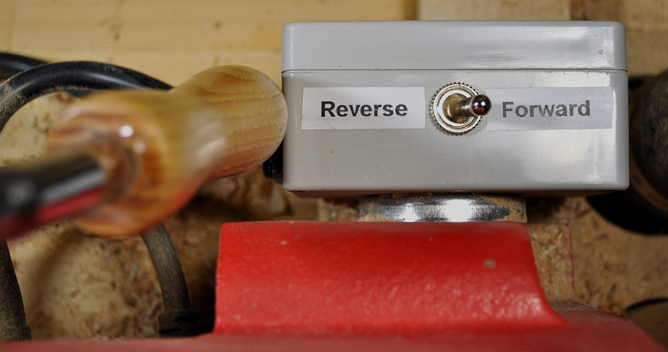

Further to the explanation of how I did my reversing switch, here is a picture that shows the finished installation.
Note that the switch box is held onto the base of the lathe using a magnet. It is actually on the right rear leg, which means that I have to reach around/over the tailstock to flip the switch. That helps prevent inadvertent reversals. If I had used a longer cable, I could have located the switch somewhere else.
Also, note that the tailstock locking handle appears to be touching the switch box. If I unlock the tailstock, and slide it all the way to the right, I can't move it back or lock it because of interference between the switch and the tailstock handle. I can live with it, but it is a nuisance that I could have avoided by using a longer cable that would allow me to mount the box somewhere else on the lathe base. That's a variation on the 'measure twice' rule!
