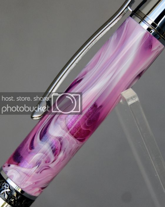

With colors like this I'll do a couple coats of pink and then 1 coat of black. The pink paint won't be opaque enough so that's why I use the black. Here is an example:
Same process but I used purple.
