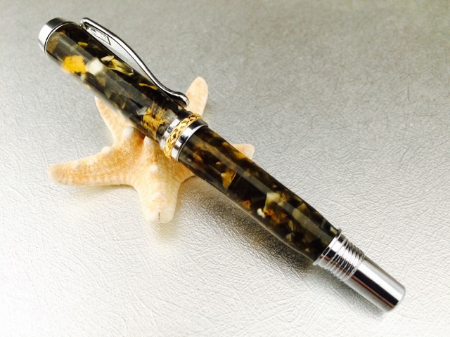

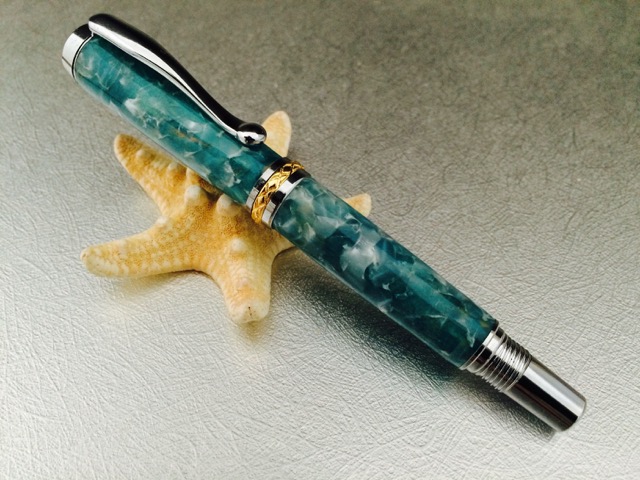

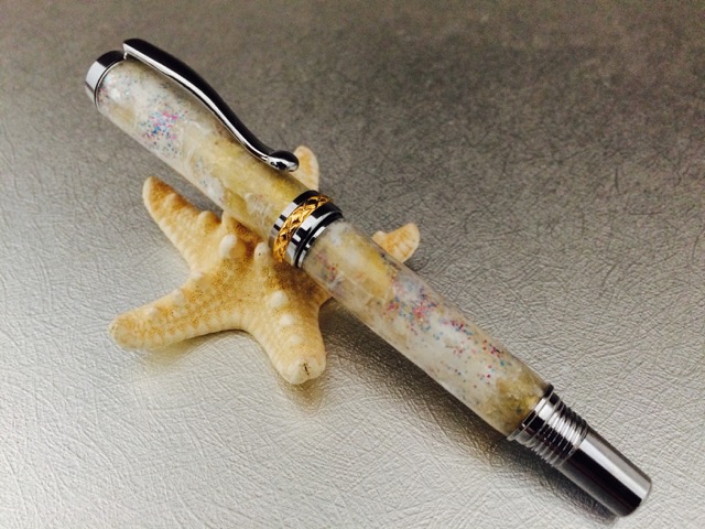

Someone posted a thread asking about painting tubes and was given a lot of good advice. Someone also pointed out the different effects you can get from reverse painting the blank.
Here are 3 tritons, all made with a cream matrix blank (I really love this blank!).
The first is reverse painted with a sparkle nail polish, then white acrylic. The second is reverse painted with a teal acrylic, then an orange acrylic. The last one is reverse painted with a black acrylic. Same color blank to start - but 3 very different effects.
C & C welcome.

Thanks for showing the results of your experiment ... very interesting.
Where could I buy that same cream matrix blank ? ... or did you make it yourself ?
Wow! What a difference. Remarkable! I would have guesses three completely different blanks. Impressive work. Did you borrow your wife's polish or was it your's? :tongue:
Nice job, thanks for sharing. Do you oversize the bore hole to provide an allowance for the paint, especially the ones with extra color?
Mitch, the results are very dramatic - I was not expecting that difference when I turned them. It's hard to tell when you just have the full blank with the inside painted.
Leslie, it is a very transparent blank. All of the matrix blanks I have are the same way.
Mal, I've never cast a blank - beyond my talent. To the best of my knowledge, these are an Italian lucite that is no longer available. I've got my trusty 125 pound attack Labrador guarding them - just don't offer him any treats:smile:
Dennis, I'll never tell if you won't:wink:
Nicole, there are never any dumb questions, only those that you never ask. This forum is a great place to ask questions and learn. One thing to point out is that you get different effects from reverse painting vs. tube painting. I posted two purple matrix pens, one reverse painted & one tube painted. Quite different.
Harry, thanks for answering Nicole's question.
Cody, I don't over bore the hole, but I do run the tubes through dry several times to make sure they move freely. I had to run the drill bit by hand on just one blank.
Dan, you're welcome!
Michelle & Rich: thank you. I do like the teal one best myself.
