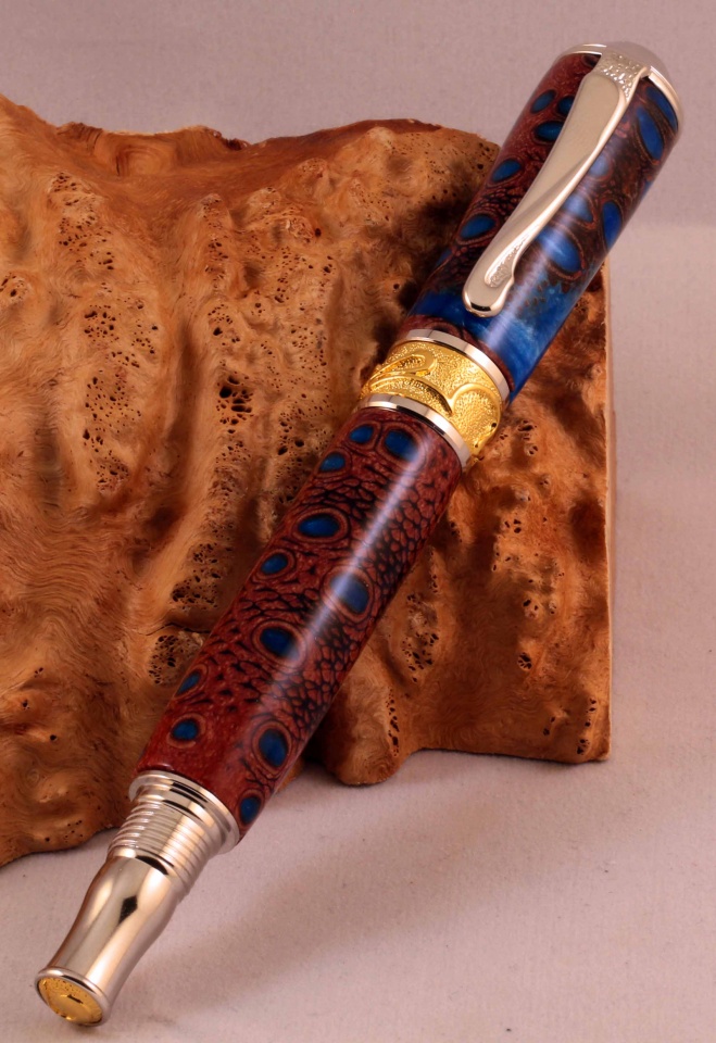

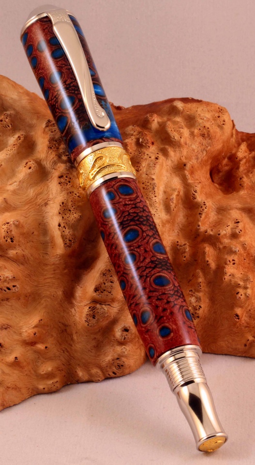

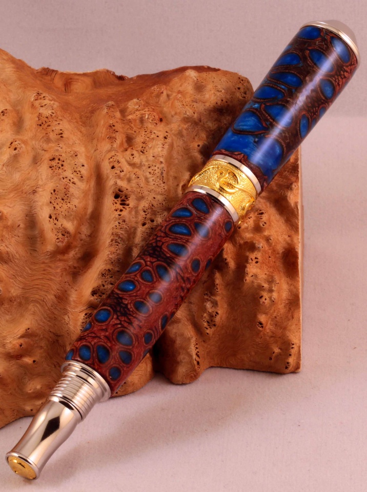

G'day Mates,
Its been ages since I put up anything on IAP. I have been doing a lot of turning, just didn't get the chance to put stuff up. I had been working on a catalogue of pens, as a lot of friends asked me to show them samples, and I had none, as I made them to specific orders. I did however have pictures so I finally made the catalogue. So I hope to be able to put up some pens from today on IAP. I am always open to C & C so I can improve. This is a Noveau Sceptre Pen in George's blue banksia. This is a very popular blank and turns out really well. I like this particular kit too.
Cheers,
Sean

......she's a beauty, are the Dwarf Banksias as fragile to turn as the big brother Banksia pods?..........Be well........Jan
Well to turn the dwarfs I follow George's advice, carbide tools or flap discs. Thanks everyone for the feedback and its good to be back!
Hi Jean,
The short answer is "NO", they are a lot easier...!
The pod construction is different, you have a lot more solid pod material in the dwarf blanks and also, I use the pod core/centre so, a more firm structure.
They do have a small amount of that dreadful red velvet but a very minor amount easy to handle, the most important thing to consider when turning these blanks is, the resin is filling the tiny seed holes, these holes become smaller/shallower as you remove material from the blank therefore, the resin loses a lot of its support and can be shaken out and fly away so, the very first thing to do is to maintain an average lathe speed of under 1,000rpm, centrifugal forces for excessive speed, with shake and loosen the bits of resin inside those holes and they will "depart" at great speed to never be found again. The second most import detail is to remember that, if the resin is losing its support and can become loose in the seed hole, you need to strengthen that bond and for that, you simply soak the blank with thin CA and let it set before you continue on, doing these simple steps, you aren't going to have any other issues, still be gentle...!:wink::biggrin:
Cheers
George
