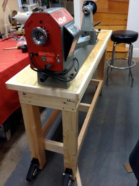

Today, I am finishing up a bench for my new-to-me (used) Nova DVR XP lathe. Though not a fine piece of furniture, it is built like a brick . . . bench . . . dado'd, glued, screwed, and lag bolted. On the ground, it's rock solid. Since my workshop is tight, I need to be able to move it around via retractible casters. As you can see from the picture, I attached a set from Rockler. I will call Rockler on Monday because these aren't working and, I think, are dangerous. I don't believe that I've exceeded the weight they are designed to hold. But in order to retract them, I have to use a pry bar and block to pull up the lift mechanism. This is after I lubed the mating surfaces with a very slick lube, and then lithium grease. Beyond that, individual casters were a bad choice on my part because, since the lathe is deliberately bolted off-center, if I lower the wrong side first, I fear momentum could cause the whole business to topple. Any system needs to lift and lower both legs on an end at once. Does anybody have a recommendation? Thanks, Russ

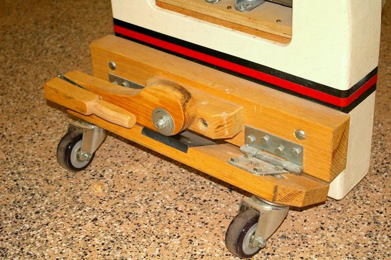

Here's a simple but solid and effective alternative. Built using standard hardware and non-locking polyurethane casters. I made the cam such that it lifts the Jet 1642 lathe a mere 1/2" off it's feet as mine has to be mobile. I did a similar set for my maple workbench.

Thanks for your suggestions, guys. I'm always impressed with the cleverness of people on this site! The cam action is pretty neat, and the Harbor Freight base looks like it would work well. I'm still hoping to find a bolt-on solution with two wheels on each end, easily operated by foot. If I can't get that, I'll try either of the two methods above. Much appreciated! Russ
That looks really nice, Dick. Do you have plans for this or did you just wing it? I'd like to try this for my 1642.
Thinking the same thing. I suppose if I searched hard or long enough, there are some plans out there to be found. Would like a stand for my newly purchased 1220vs.
I posted these on another forum several years ago and got a number of requests for plans. I din't have any, but I'd be glad to take the measurements and a few more photos and put them in a pdf for anyone who might like them. Just PM me and give me a day and I'll send the info to you. One fellow built a set and several in his club did likewise....all happy campers:smile:

BTW.....I now have a fully documented and dimensioned .PDF file of the retractable casters that I posted earlier in this thread if any one has interest. Free for the asking through PM.
