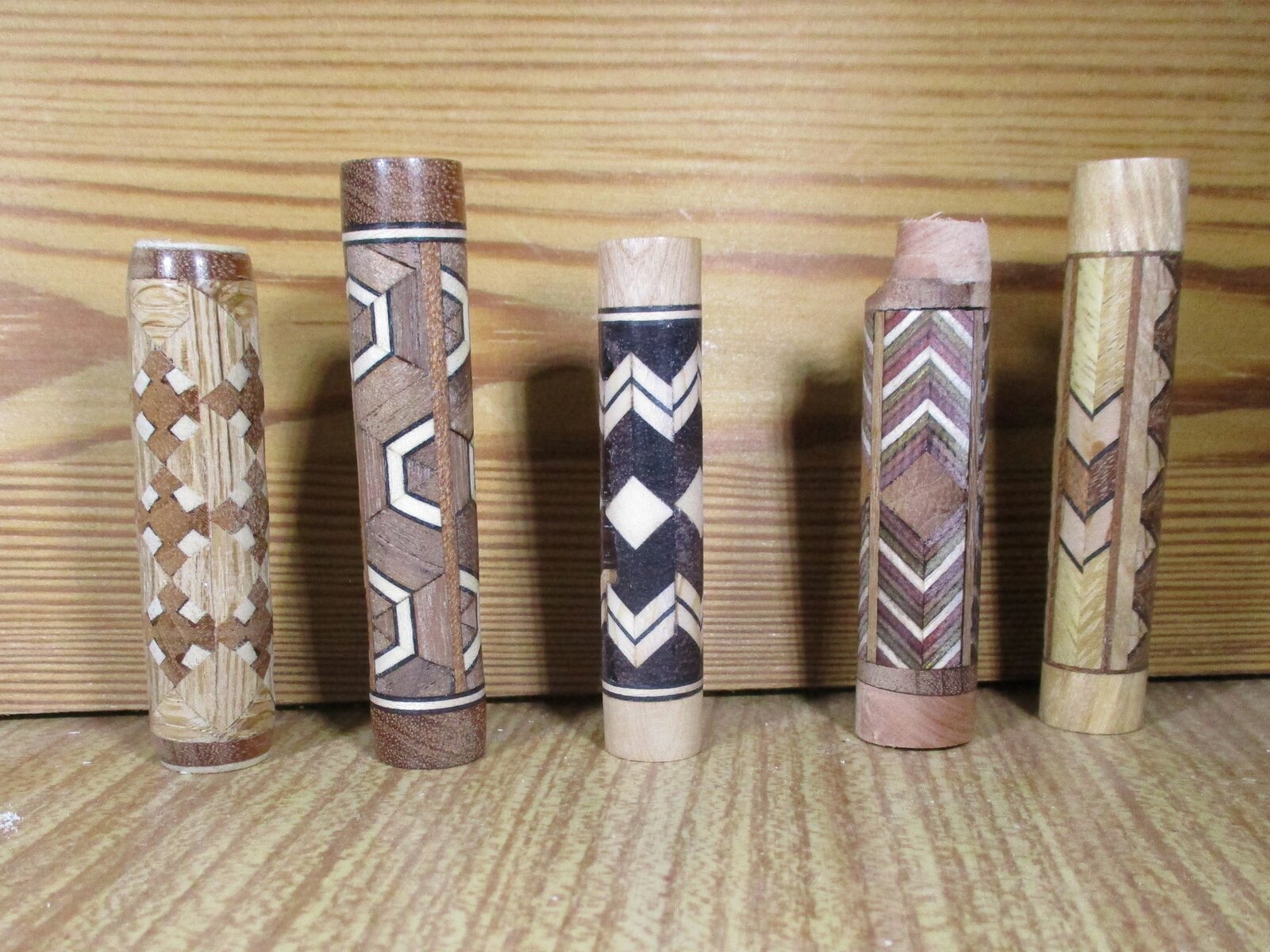

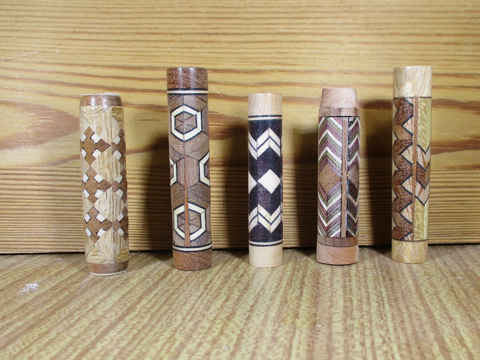

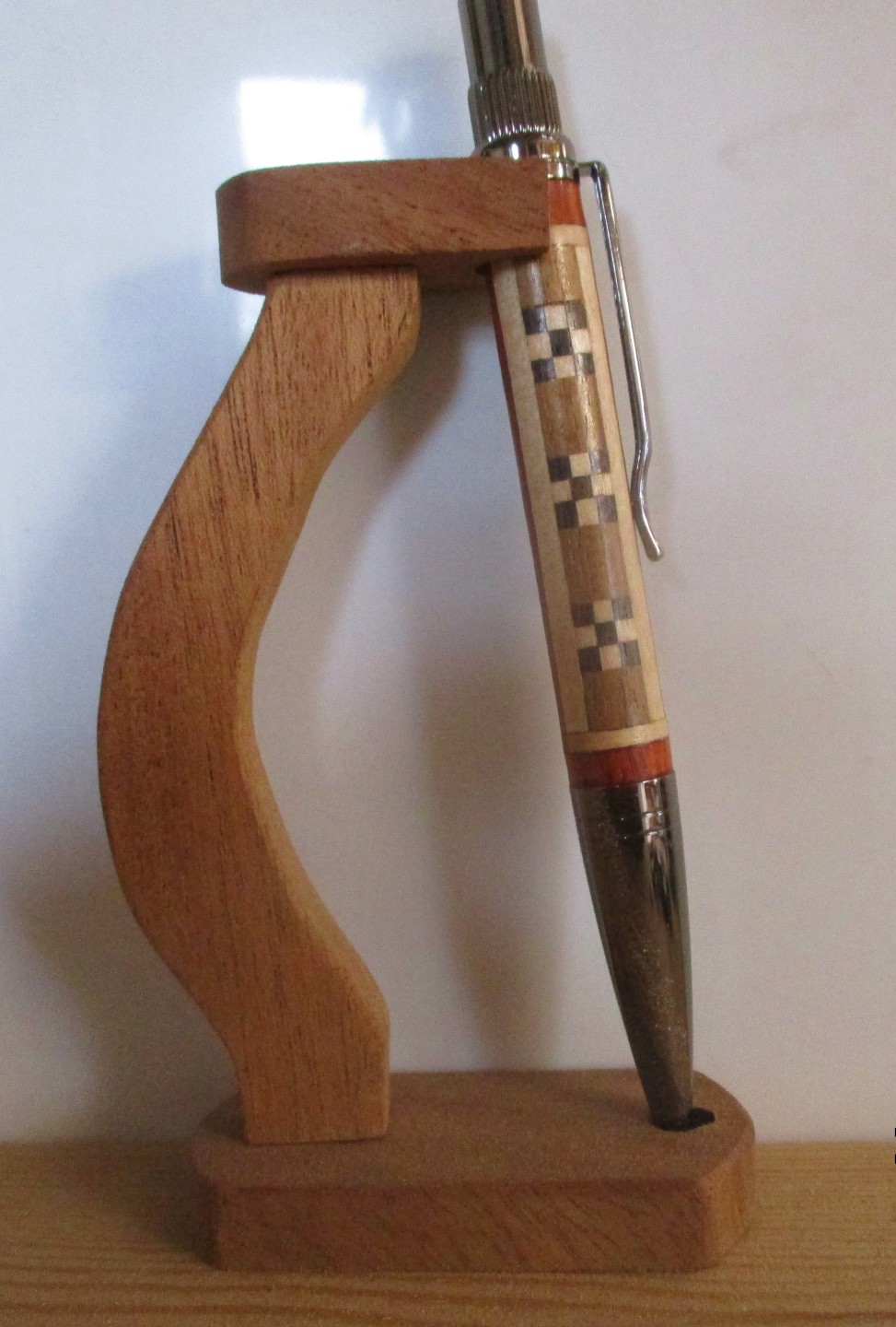

These are the blanks that I showed yesterday now turned.
I stopped turning number 1 as the pattern was starting to merge. I think that it would look messy if I took it down to the bushes. Number 2 is a non runner as nothing lines up. There is difficulty lining up the patterns in number 3 because of my construction method. I will try a different method, though it shows a bit more promise than the others. Number 4 is not too exciting and number 5 has 2 different designs which don't really work together.
I may try a couple more blanks but the design and the construction method will have to change. It will give me something to think about before I go to sleep. All comments appreciated. Thanks for looking. IMG_2664.JPGIMG_2665.JPG

1 thru 4 all show promise, not a fan of number 5.
Thanks Ken. Actually No.5 was just 2 different blanks i had lying around and stuck together. All those blanks were a 'suck it and see' experiment to see if I could get a blank that looked good all around. My wife thinks that they are 'too busy', so back to the drawing board.

I don't think they're too busy at all, if everything lined up they'd be prefect

I do not think they are too busy. My thoughts and just my thoughts I like the design of 1 and 2 on the left. I am just tired of see chevron pattern. Everyone keeps calling that a Gisi pattern but he at no time invented that design. That is a bowl turners design from way back If you could zero in the first 2 designs that would be cool. Many design can come off those two.

Alan, I like where you are going with your explorations, A+ for effort imo. It's certainly an interesting experiment to push boundaries / limits, and to refine process.
As for "back to the drawing board" don't lose heart. I have the luxury of using CAD to do most of my exploring, and discard many "ideas" before I even put a stick of wood through the shop machinery. Some I make any way, just because. :)
I've found it easy to come up with a nice blank design. However, like many of my ideas and so many of the segmented blanks I see offered for sale, they look great as a blank, but the blank design does not always make for a nice turned pen.
Apart from the aesthetics, and the technical stuff of actually cutting the components then assembling the blank, the practicalities of turning and then use eliminates some avenues of pattern design imo. The ultimate test is ensuring the final wafer-thin sleeve of a composite veneer can withstand the rigors of turning and then long-term use.

Alan, thanks for showing the results. They are very interesting... I like all of the designs. I don't think they are all too messy. I think the different designs of blank 5, is a bit of a problem, but 1-4 would make for some excellent pens!
This shows that alignment is not just a surface-level thing. I am curious how you deal with that when creating a segmented blank? Is there a technique that ensures alignment through the full depth of the blank?

Alan I might as well say this here as well as I did on the other thread that someone posted on his designs. I like your attempts to try to make a 4 sided design that encircles the blank but I feel it takes away from the design. I like the 2 sided designs for the fact it opens the design pattern up to the point it can be more easily cut. cutting pieces that small is dangerous unless you have a great jig to hold your pieces. The fact you use CA does not give you the flexibility to adjust the pattern. I would think slow the build down and use wood glues being you use all wood material. Just some thoughts from me as you grow into this segmenting stuff. As I said in the other thread I may have to jump into this arena myself with this type of segmenting. I never did anything like these type patterns. My segmenting is router based and trim ring based. Right now I have my toe into so many other different type blanks I have been making all winter and hopefully can start showing the fruits of my labor. I will continue to follow your progress as you go down this path. Good luck and stay safe.
