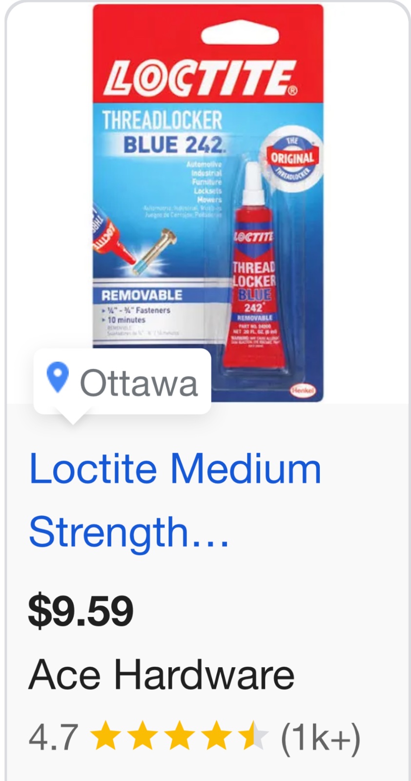

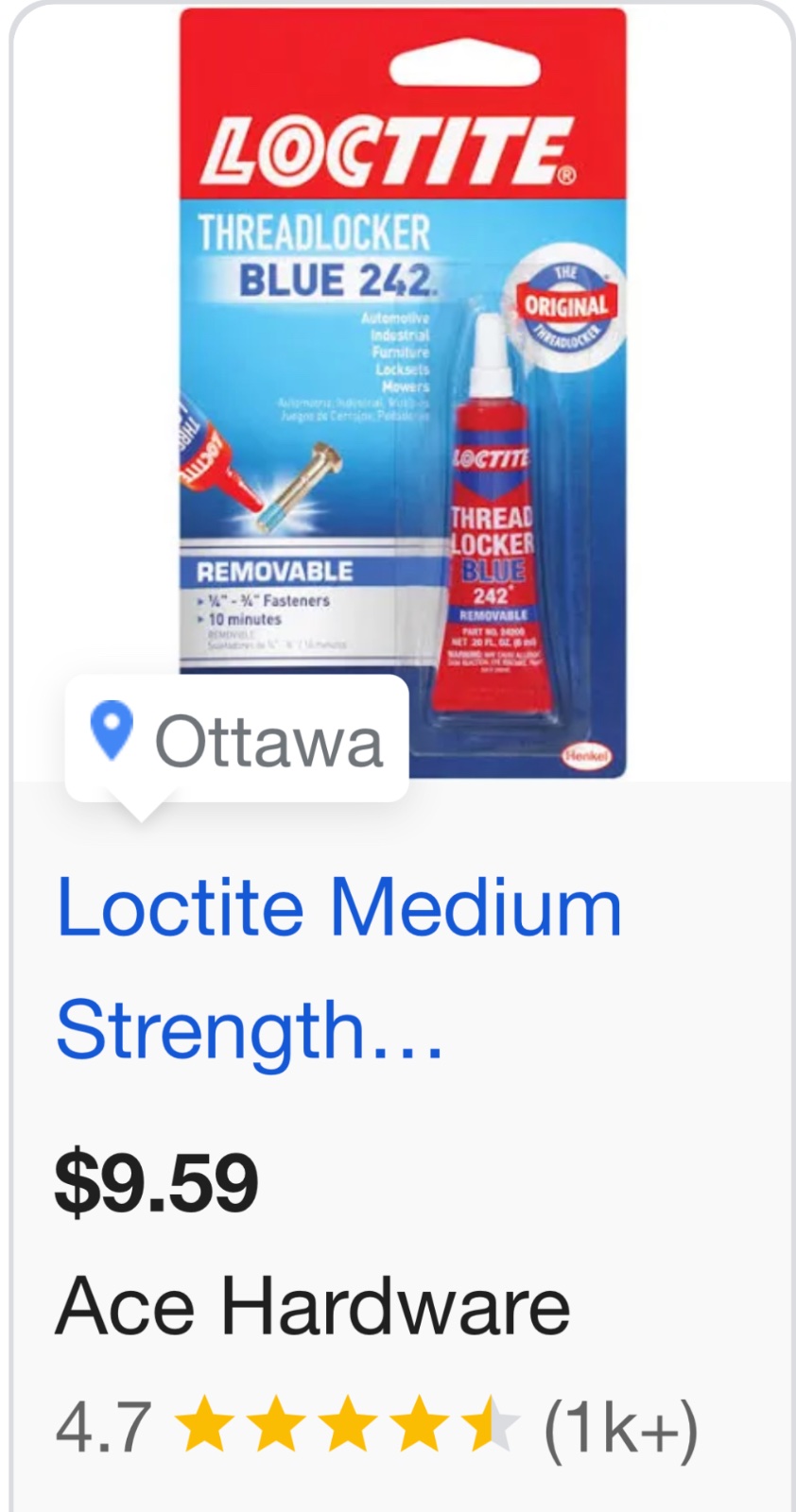

Glad you found your problem. I used to use epoxy during assembly also but had issues of my own. I dripped a little on my finish and it ruined it. Since I have switched to blue loctite. A very small drip does the trick and it wipes up easily and is thin so if it gets inside a tube it doesn't build an obstruction. Also, as long as you use "blue" it can be disassembled with a little effort. Just don't use "red", it's not made to come apart.
Thank you. I have tried red and blue; it works, but doesn't stops clips from rotating as the pen gets handled. I actually rather use loc-tite, but I found the epoxy to hold better (not perfectly. I would really like to "weld" the clip somehow. I looked into jewelers tools, but too expensive. The rotating clip doesn't seem to concern many; it just bothers me. Thanks again!
I get it. I dont like them either. I actually put blue loctite on the top of the clip ring that the finial goes through as well as the brass tube when fitting the finial. That way it secures the clip to the finial and doesnt spin. Ive been doing this for years with success.
