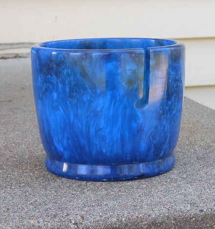

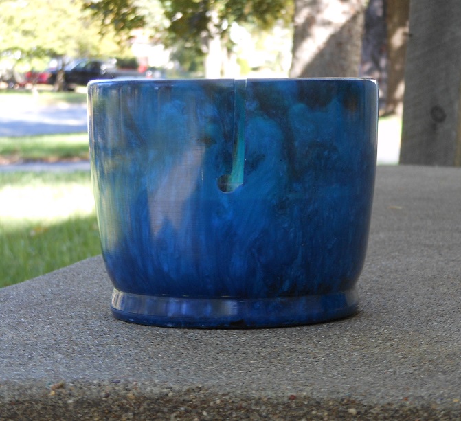

Seeing as how I've been having trouble finding wood blanks the right size to turn for yarn bowls (5x5x5, and unfortunately I don't own a band saw), I thought I'd try casting a blank. I used a small paint bucket as a mold, and sunk a 2 inch diameter pieces of pvc with a taped off bottom in the middle to save resin and labor. As a prototype it was pretty successful, but I've found that it's really hard to get all the tool marks out, and I definitely need longer tools.

I'm thinking you did a great job! Makes a pretty bowl. My wife does some knitting and I'm always looking for ideas of things to make her. Add this to the list...
That looks great, what kind of resin did you use?
How did you get the pvc "plug" in the center to stay in place for the casting?

I used regular old poly resin. When I bought my original casting kit from wood and whimsey, it came with a bag of steel shot for weighing down pen tubes, I put the whole bag in the 'plug' and then used long strips of tape across the top to encourage it not to drift or tip.
Hope that made sense,
Mickie

FYI, a classic yarn bowl has more of a J shape to it's slot, I'm sort of working up to it.

You did a beautiful job on the bowl. You mentioned a J shaped exit for the yarn. If you used a long thin bit in your dremel or grinder you could easily make that shape. For tools marks I would use sand paper to smooth them and just move up grits. I would also wet sand as it removes marks best in acrylic.

I like the shape, and see nothing wrong with the finish(although you are probably referring to the inside). Wet sanding is your friend, be it very messy though....
The mold was a get idea, and the piece to reduce the amount of resin....awesome!! You got to make some more, that one with need 'friends'!!!

Nicely executed and definitely one to be proud of. As for the tool marks... I use extra fine steel wool after my sandpaper and before the micro mesh. Just lightly work the piece over with the lathe on high. It will help remove the deep scratches from the sand paper and you wont have to work so hard with the micro mesh wet sanding. Nice job on the casting also!
