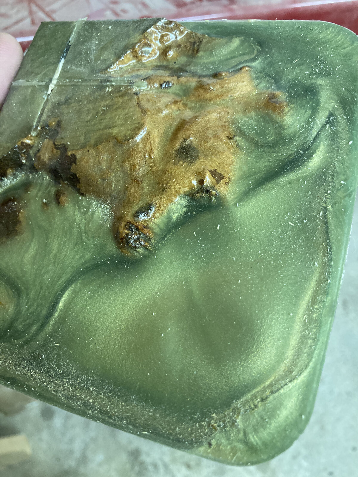

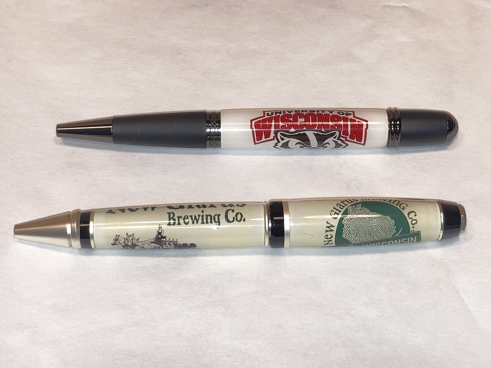

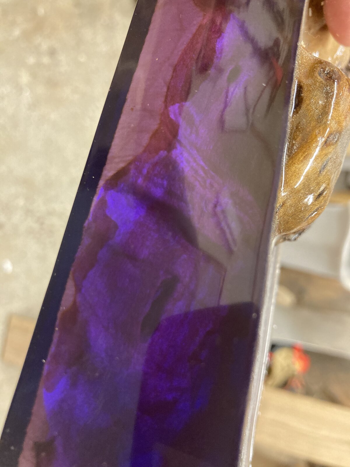

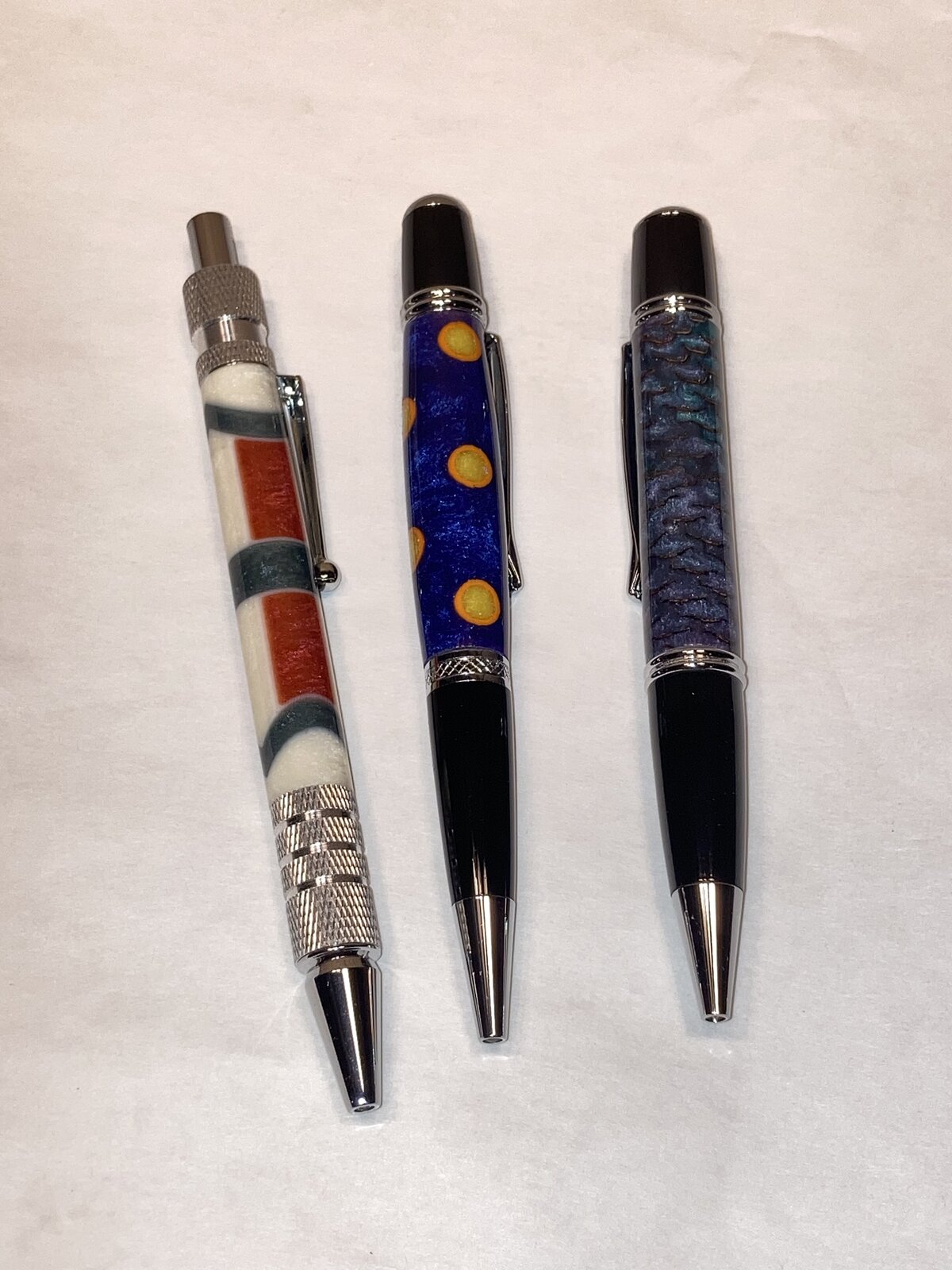

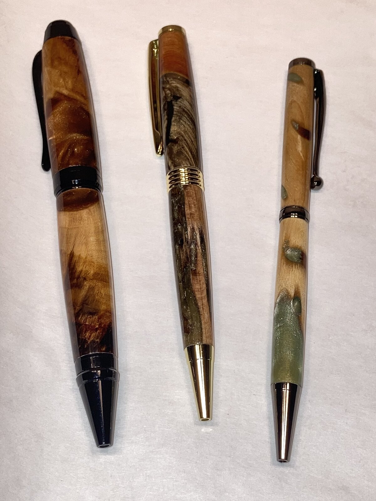

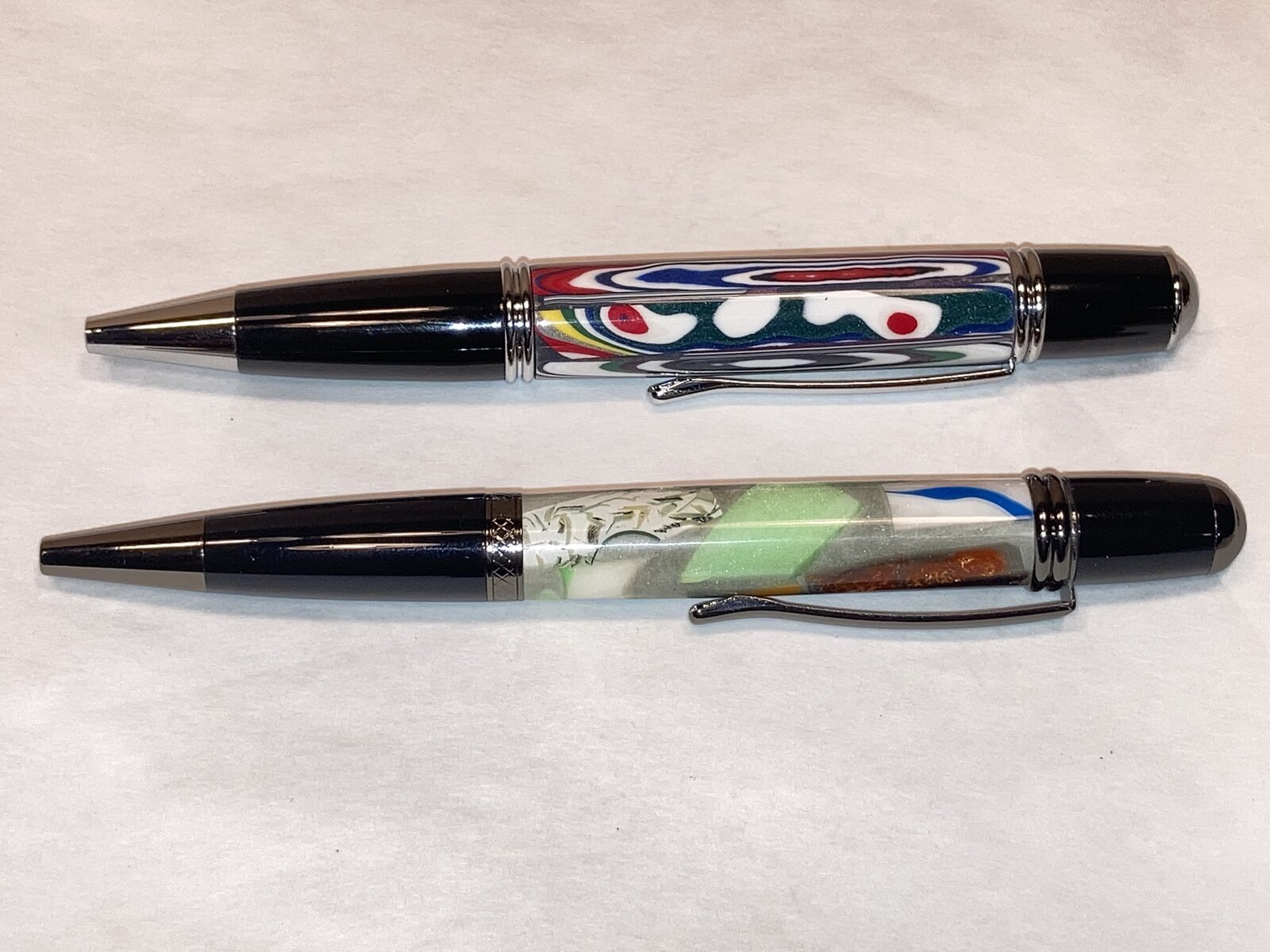

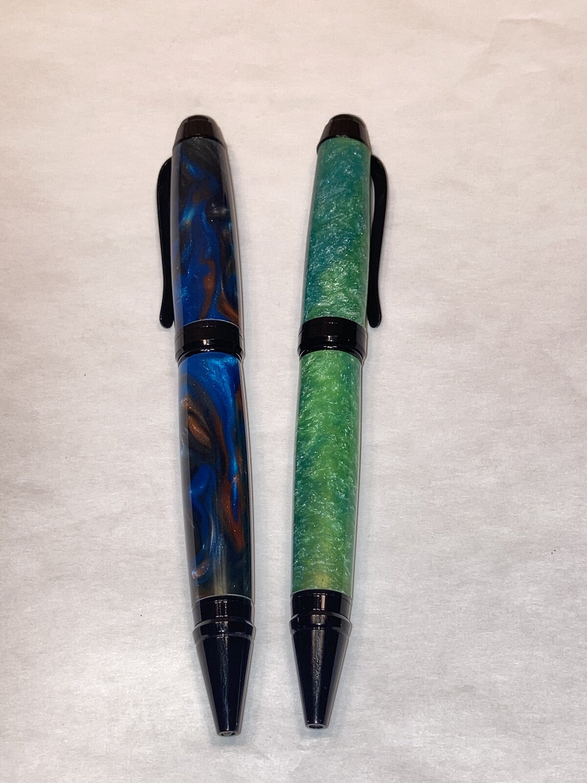

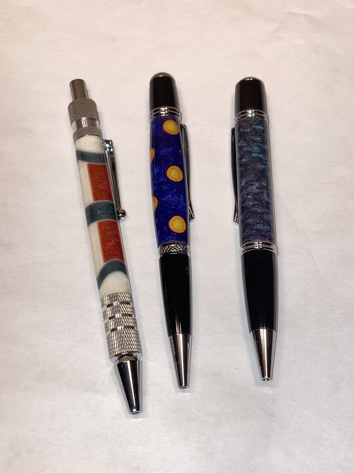

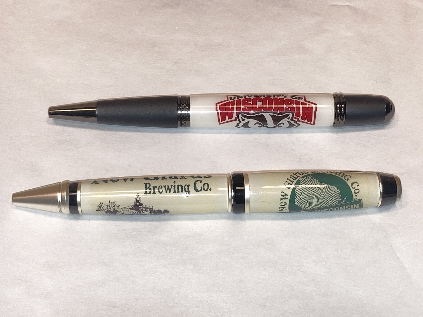

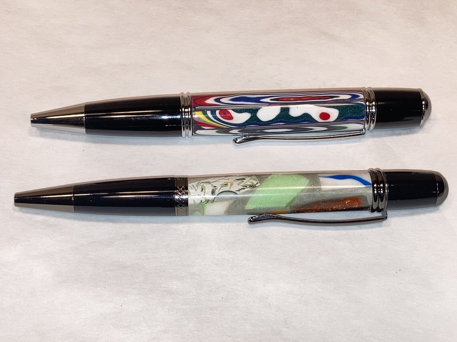

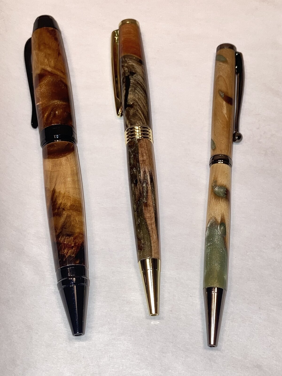

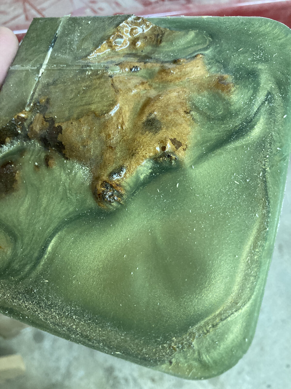

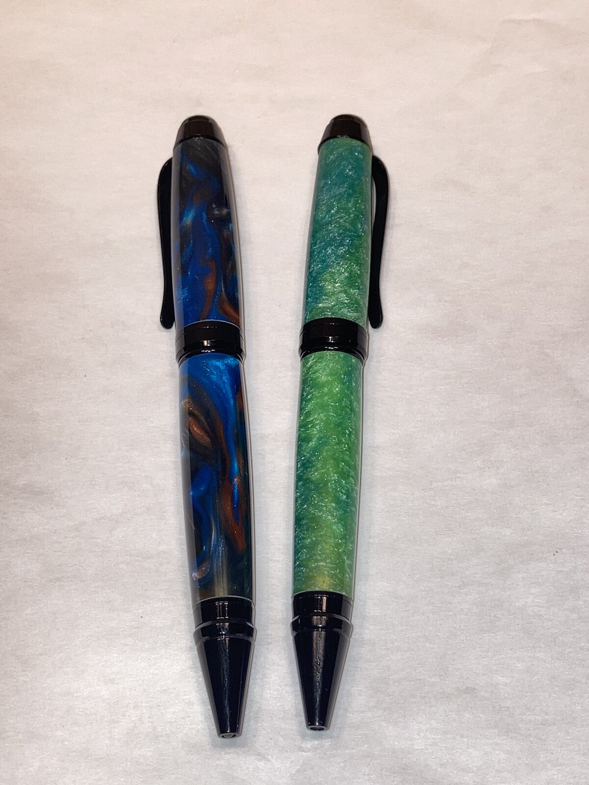

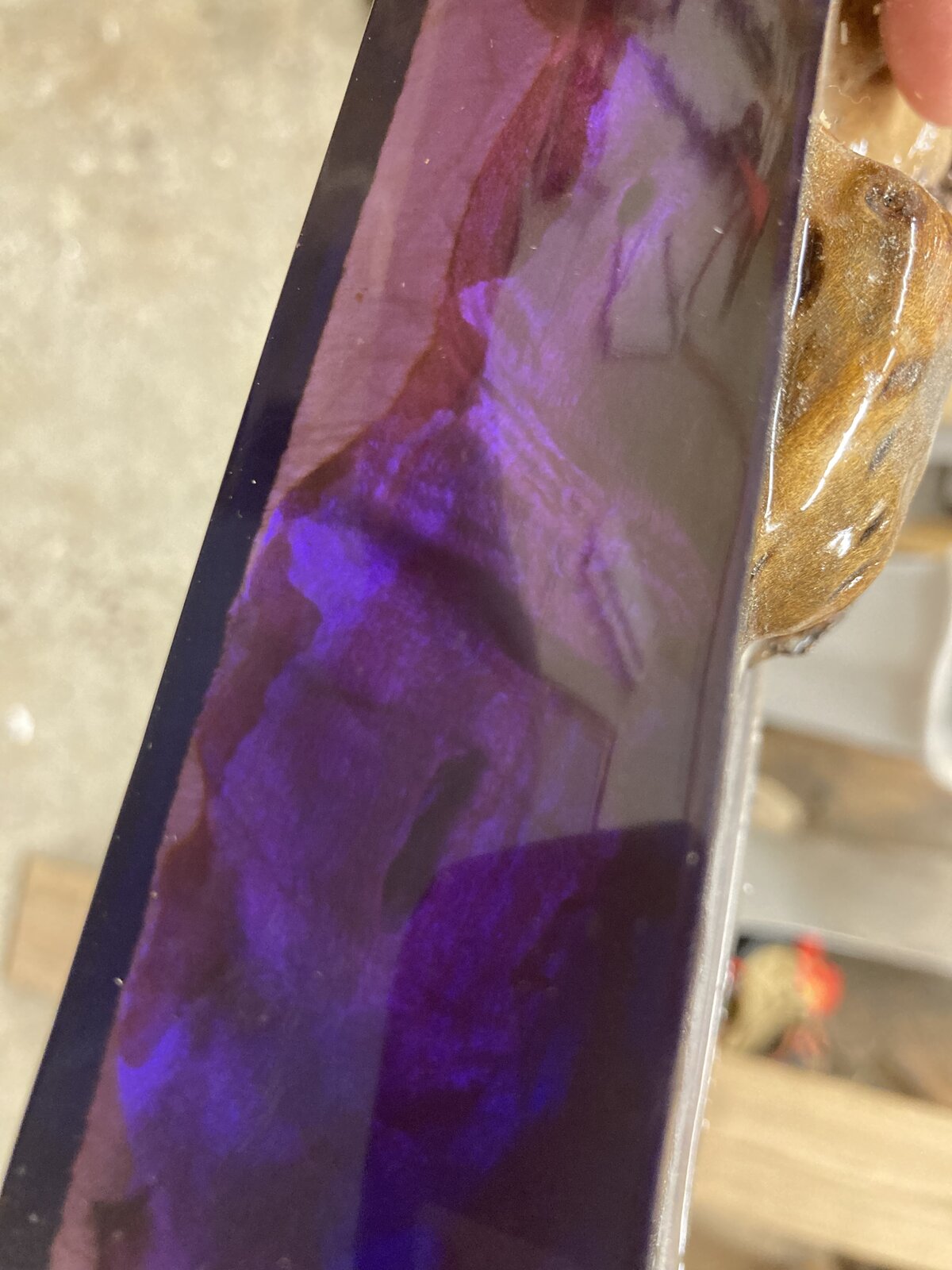

Here are some different pens made with that epoxy. Epoxy with mica powder. Label cast. "Worthless" wood. 3D printed mold filled with epoxy. And imbedded object. Also included the last couple blocks that I haven't cut up yet.
