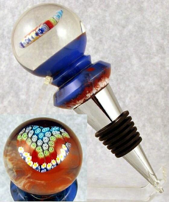

Here is an example of what you want to do but a different application and believe me I have dropped these props more times than I want to count. No chips or breaks. Now if you drop any resin cast items on concrete there is no guarantee and that includes Alumilite.

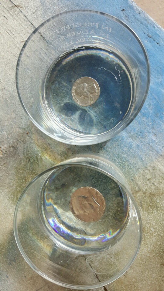

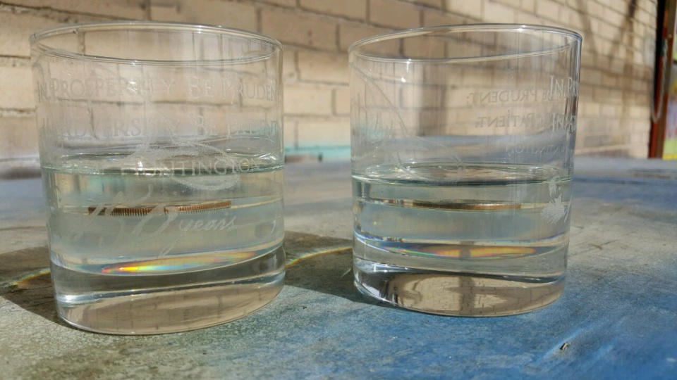

Here's the first test casts:
They're not perfect and have a line where the first and second cast layers meet, not as bad as the picture looks, but clearly visible.
Cast the first layer Tuesday and the second on Wednesday, all inside in the climate controlled shop. 35-ish psi.
The surface on each is wavy, ambient temp is about 68°. The quarter is pressure cast, the half-dollar is not. Yes, those are fingerprints, both are curing in the sun, now.
You waited too long to make both casts. When one sets up pour the second on top and the line disappears. Be careful with the sun. It does not have UV protection properties so it can yellow on you if left too long.
There was a fellow here that used this technique all the time in his bottle stoppers. What he liked to do is color the bottom layer and then clear the top layer and if there was any discernible lines they were not visible at all. It gives a depth of field. I have used that method and works great. His name was Ed Davidson and went by the sign-on name of Yo Yo Spin. He was a true master and has many videos here and his yo yo's were outstanding. Have never seen anyone come close to what he did. Check his album out in the photo section and check his videos out in the library. Look in his gallery on that page and you will see his bottle stoppers with the exact look you are after. His work was tremendous. Years ago he had a web site on Yahoo that I was a member of and all it was dealt with bottle stoppers. learned alot from there and saw first hand a masters work. No longer there.
www.yoyospin.com/tutorials/
