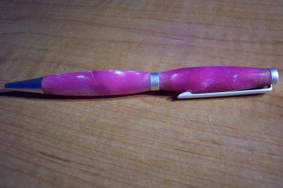

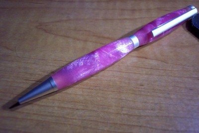

Made my first block for resin blanks last night. I made it pink with pearl and sparkle luster powder. (for the ladies of course!) It looks great, just have to turn and see how they look. I will post pics and maybe offer some if they work out. Much cheaper than buying them. I'm going to make several more tonight.

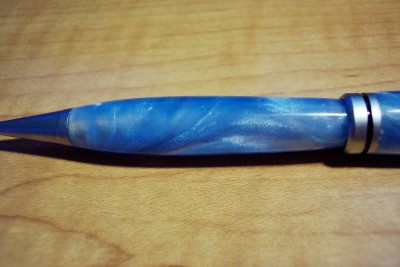

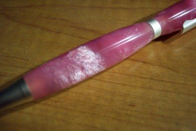

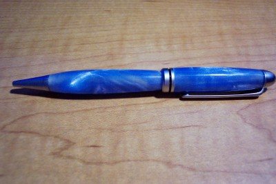

Pictures don't do this justice, but you get the idea.

Coach, they came out great! I'd love to hear what you thought of the process. I have something I want to cast IN some resin, but have been reluctant to try.

Hey Coach...way to go..nice looking pens and castings. You are having too much fun. Congrats on making the playoffs...our girls are in also.

BTW... the blue one is great... I really like it!
