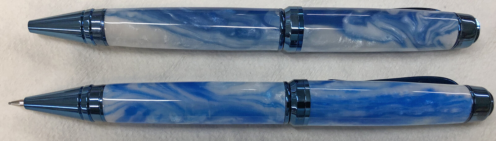

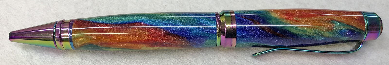

I've really learned a lot with the blanks you sent me, thanks again. The one in the picture came from you, don't know what it is... but it's hard as a rock and stunk up the whole shop when I cut it! The ones with your name on them turn really nice. I'm thinking of trying a Rhino, Aquabright or Kirinite. Any advice on those three?

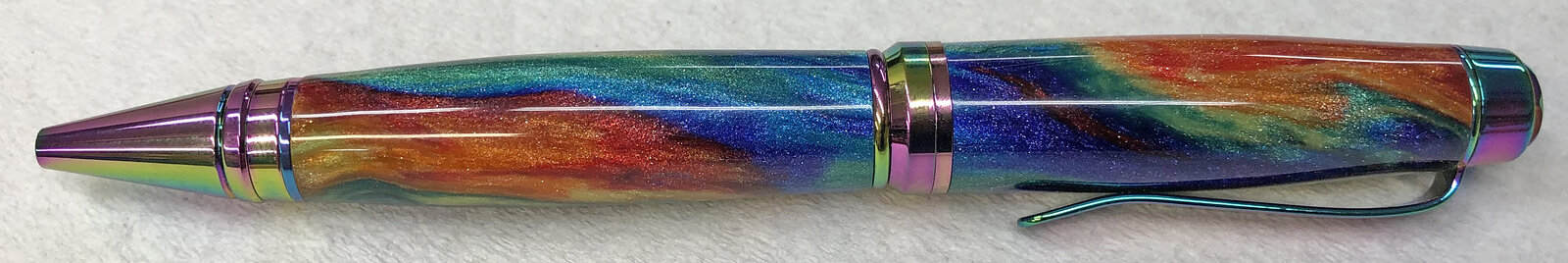

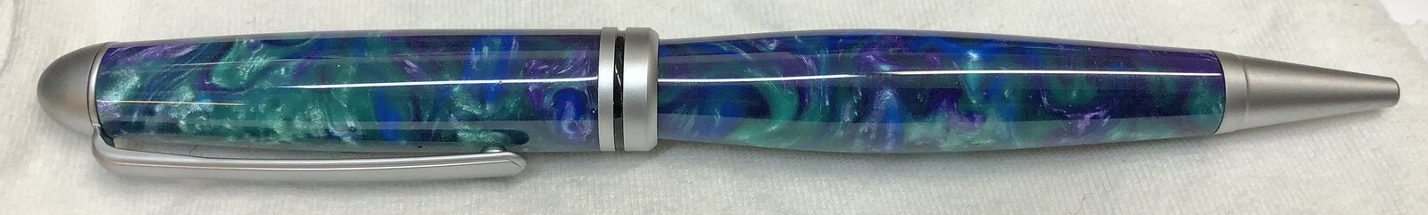

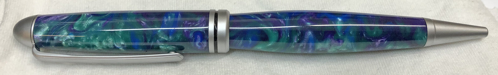

I started out with the Inlace Acrylester blanks from WoodTurningz - I think because there was such a fantastic variety and the price was right - usually less than $4 per blank. In my opinion they are one of the most difficult blanks to turn as they are typically very hard and brittle. Even the corners and edges of many of the blanks are chipped out from being sliced into blanks because of their brittleness. The best way to turn them in my opinion is to use negative rake cutters. I think that is the reccomendation from the supplier as well. (I still have a big box full of them as I really don't buy them anymore and I rarely go to them for a project).
Here is a pen I made using an Inlace Acrylester called "Peacock":

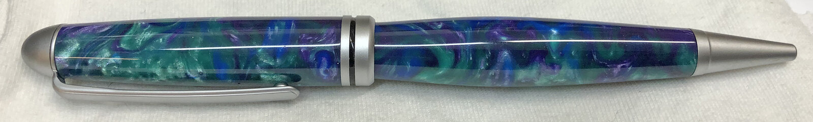

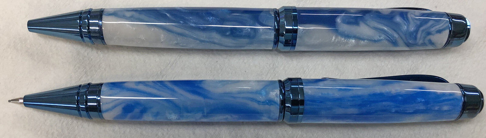

Although many indicate that they are the 2nd most difficult to turn, after Inlace I started buying Rhino blanks. True they are hard, but in my opinion not nearly as brittle as the Inlace. The price is usually great on these as well, sometimes as low as $3 per blank. I have had mostly successes with them and the few failures (cracks and blow-outs) I've had were because of my imatience when drilling. They are still my go-to blanks when I decide to make something out of plastic.
These were made using Rhino blanks called "Blue Sky":

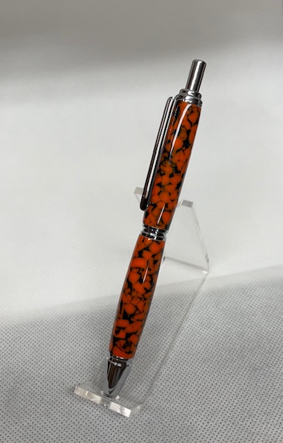

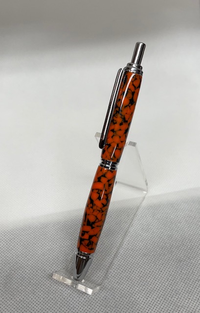

Compared with these, the blanks advertised as Alumilite have turned like a dream. They are considerably more expensive though. I especially like the DiamondCast blanks that are made by Tim McKenzie at McKenzie Penworks. (They are also sold through Turners Warehouse). The one's that I have used have made beautiful pens!
This was made using a DiamondCast blank called "Oil Slick":
Thanks you, I'm glad you got to turn them. I dont remember all that I sent but the colored square blanks with my name were urethane resin from alumilite. Clear cast feathers are Silmar 41 poly resin. I don't over heat them and let them cure longer so they turn smoother.
Most commercially made blanks will smell and turn similar to the one you posted. I believe that is a Conway Stewart. You have to be careful with commercial blanks when drilling because they can clog up the drill bit and hole and create a lot of heat, stretching the drilled hole out making it larger than intended. Step drilling helps working from small to larger bits as long as they aren't Brad point bits. I think Kirinite turns a little easier than Aquabright, and I believe Rhino blanks are poly-resin so they'll turn and sand down a little easier than the other two. I would suggest painting holes in all of those blanks so the brass doesn't show or shine through when turned down. The only blanks I don't paint the holes with are the colored blanks made from alumilite white urethane resin. They cure very opaque. The problem with urethane blanks is they don't shine up as easy as poly-resin. An easy fix for than is a CA finish. Good luck! It's all fun turning and worth the experience. Oh, and If you didn't like the smell of the acrylic, don't drill or turn antler….. it's worse!

Greetings from Nebraska.

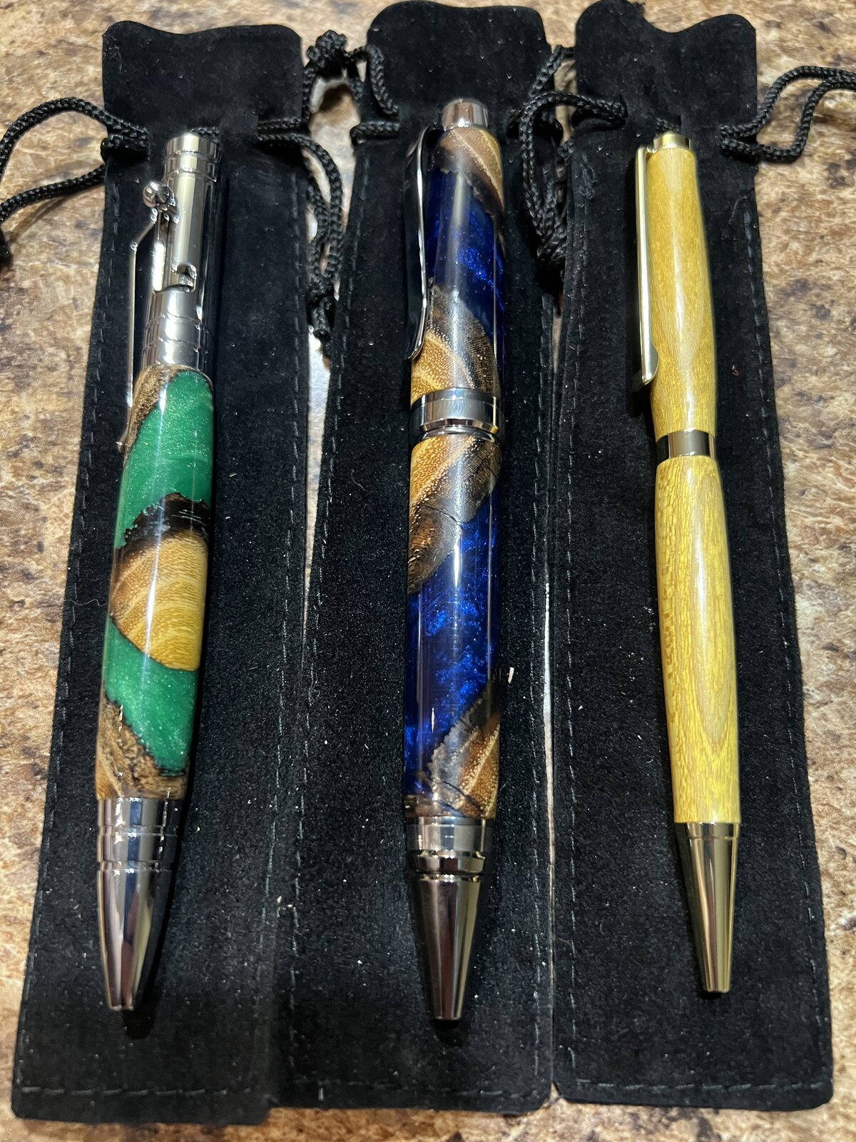

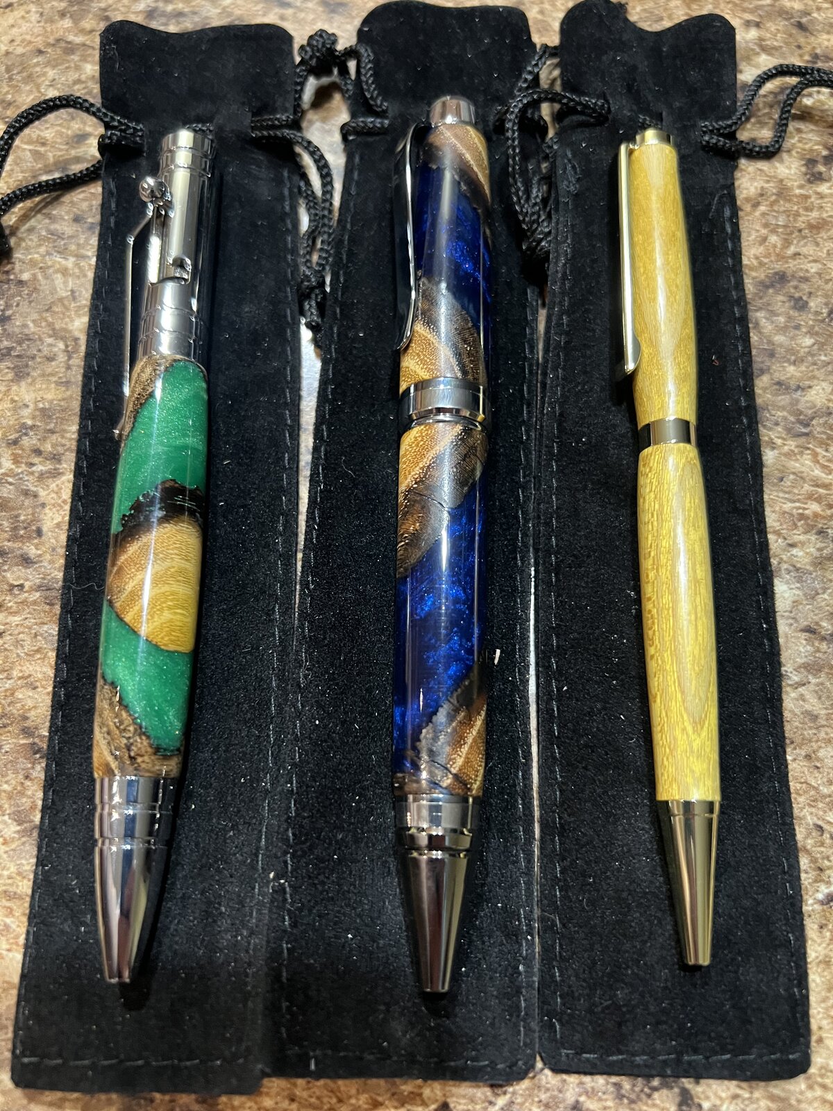

I recently got into hybrid blanks and tried my hand at some endgrain osange hybrid blanks. Turned out pretty decent.
