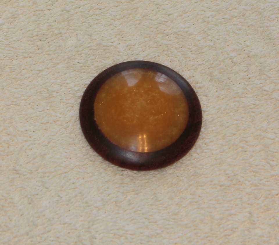

I tried to make a pendant by turning a rosewood blank and drilling out the middle. Poured in PR and let dry. As I turned and shaped the pendant, the rosewood ring turned loose from the PR. What should/could I have done to make a pendant with a ring of wood around a PR center? Thanks.

You are right Mitch. All great info. I did glue the ring back on and turn it. Worked out ok, seems tight to the PR. I finished everything with CA. I want to experiment a little more. Thanks again for everyone's comments and help.
Proof!!

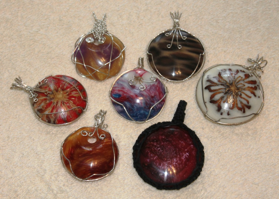

So, here it is....thanks for the help. The other pic is some other pendants I made and wrapped for the "sweetie".
Yeah, those pendants are sweet, particularly the ones where you center casted a dry pod in the resin, they come out very good...!
