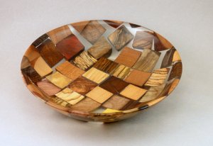

Inspired by Brendon Stemp's "Resin and timber cutoff bowl" video I decided to use up some of my pen blank cutoff's and give it a go myself. The "saucer" was one catch away from being a 2.5" high bowl. Final dimensions are 5.5" x 1.25". It's made from randomly placed pen blank cutoffs cast in Alumilite. The saucer was sanded to 600 followed by EE-Ultra Shine, and buffed.

Great bowl/saucer!!!
See you used Alumilite. Did you need to use a pressure pot?
Also see you used the EEE stuff for the finish, seems like it did okay...would you use the stuff again or buff?

Thanks for the comments.
Yes I did use Alumulite and I did use a pressure pot in fact I'm waiting for my new larger pressure pot to arrive so that I can last larger bowls and platters.
I have used EEE quite a bit, it does a nice job. I did buff this bowl after the EEE to help with the shine.
