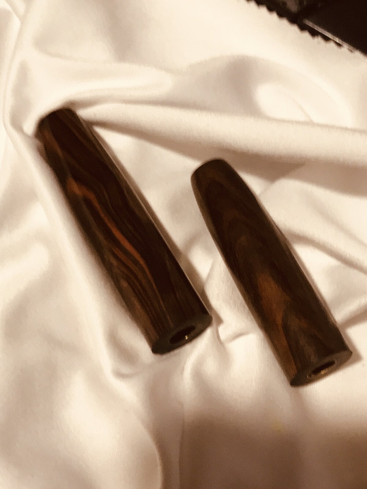

I came into possession of a 5"x5"x24" chunk of really colorful Macassar Ebony. In playing with it, making a few pens I have found this wood to be quite oily. I don't think it is a candidate for CA; I could be wrong. I tried Pens Plus, It darkens the wood up too much, obscuring the beautiful veins of pink and green. What you be your recommendations? The blanks in the attached photo are turned for a SlimLine - actually a SreamLine or a Roadster. I appreciate your help.

I guess it could depend on what you visualize the finish to be.
One thought is to go for the natural look. I would wipe the blanks with DNA and then simply Beall buff to a soft luster.
An Acrylic polyurethane could be another choice for more of a "finished" appearance.....again, how would this do long term over the ebony?

I would suggest starting with sanding sealer then using an abrasive paste like Yorkshire Grit or Acks Abrasive paste and follow that up with the same brand's polishing paste. I use Rennaissance wax as a final step in my wood finishes.

CA is amazingly adaptable stuff.
In fact, it is often used together with Boiled Linseed Oil when doing a finish.
So it might very well "take to" working with the oiliness of your wood.
If you have a scrap of the wood you might try CA on it first.

Why not try danish oil and buff it or as has been said just sand and polish then buff and let the natural,oils do the job for you?
I have used Melamone on lignum vitae but it was not, in my eyes a success. So next o)es Imdid I sanded to about 500 grit then just buffed with shavings. Lovely semi matt finish and recipients were delighted at a " real wood pen"

I have gotten a pretty nice finish on some ebony just taking through the micro mesh grits all the way. If you wanted a little more shine, maybe some Renaissance Wax or the like, though it will not be that durable. These will produce a shinier than Matt finish but not the hard gloss of CA.

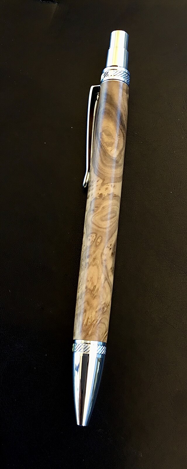

My go to alternative to CA is Mylands friction polish over sanding sealer. It lends a nice even sheen to the wood but certainly doesn't match the gloss and durability of CA. I've attached a pic of the last pen on which I used friction polish.
I really appreciate all the responses. The first thing I did was to start sanding with 320 grit wet using Walnut Oil. That really turned the piece so dark you could barely see the veination. So, I sanded that back and hand sanded (dry) horizontally off the lathe thru 2000 grit and picked up MM at 4800, and dry sanded off the lathe using the remaining MM. Then back to the lathe @ about 1800 rpm; did 2 coats of Ren wax buffing with old tee shirt between coats. Barrels looked great, BUT customer wanted a more durable finish than just wax.
Ugh - afraid of what might happen with CA, my only option was to use what I had on hand - PensPlus. I suspected it would darken the blanks from my attempt at wet sanding with Walnut Oil. And it did. So 2 coats of Pens Plus followed by 2 coats of Ren wax, and customer fortunately is quite happy.
Just to give me more options, based on some of your responses, I ordered some Mylands Sanding Sealer and Mylands Friction Polish. I'll try to post pics tomorrow of the finished pen. The pic I already posted is sanded thru all MM followed by Ren wax.

If oily enough, you might bet a decent shine just micromeshing it with some walnut oil as the lubricant (or with water) and finishing with some paste wax.

Love your finish; hope my success using Mylands is as good.
Thanks - I hope it works well for you. I've never found it to hide the grain. Took a few trials and errors tho before I came to like it. Shake the polish up really well before applying (after sealing) between coats as it separates pretty quickly. Apply medium pressure and I like to turn up the speed. You can apply multiple coats but I rarely put on more than two or I sometimes get an excessive build up in spots which won't look great. Even then you can even those out with a fresh paper towel. But I'd say if you like the finish after a coat or two, it's okay to stop (says the guy who usually lives by "more is better"😉). Good luck!
