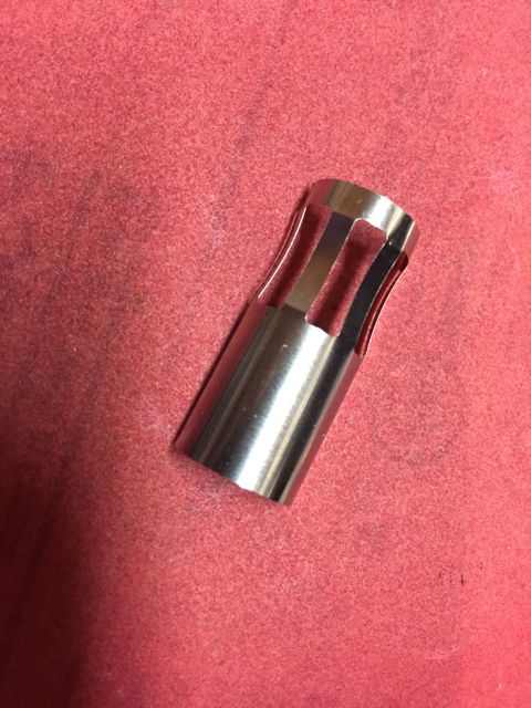

I'm looking for some material to try making a new clutch for my pen. I'm guessing it's stainless steel because it has no magnetic attraction and is very shiny and springy. I managed to find something similar that someone generously gave me, but it's not quite right, though it seems to be an identical material.
Does anyone know the name of this variety of very small gauge metal? According to my calipers it is .004" thick, and according to the chart I just found the thinnest sheet metal gauge is #36, which is .0067", so I'm not even sure I'm looking in the right direction.
Can anyone please shed some light?
I know making one by hand might not be feasible, but I'd like to try. The original has deteriorated beyond repair.
Thanks so much.

This looks identical to the spring for the seam rippers kits I make. Some knife making supply companies sell very thin Stainless Steel Foil for wrapping blades prior to heat treating in an attempt to reduce oxidization of the steel. I've seen it as thin as 0.002".
Please take a look at the following url. This is a eBay listing for a selection of brass shim material 003. and .005 but not .004 thick.
Then their is McMaster Carr that has every thing. See url at the bottom. Their thinnest shim stock starts at 0.0005" thick and goes up from there. They also have a number of other materials if SS doesn't work for you. There are a number of other places but this is very convenient place to order it. I don't know where you can order smaller pieces. Amazon also lists the material on their site but all of it is also 50" long.

Thanks for all your suggestions. I didn't even know "shim stock" was a thing, but I suspect the "spring steel shim stock" is the variety I'm seeking.
The copper is probably not rigid or springy enough, but I'm going to try it anyway, because I can definitely use it for something else too.

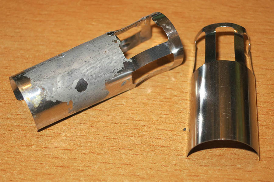

More4dan, it's very similar, though mine is closer to 1.75", and the other similar one I got is 1.5" long (just doesn't have the right spring contour). Flattened, they are both also a bit wider, at 1 3/16"... but, man, that is similar and now I'm wondering if there is a seam ripper out there that features a doppelganger component to my pen clutch.
Thanks to you, I just found this (hope this link works):
http://www.penblanks.ca/images/D/seam ripper spring instructions.JPG
The description of the tool that this fits requires an 8mm drill bit, so I'm thinking this is identical to the one you showed on sandpaper.
I see they call it a retaining spring, not a clutch.
Would be amazing to find one already made... thanks so much for the leads.

Try the .004 feeler gauge or shim stock.
Shim may or may not be available in stainless as well as standard steel, but it would also be available in brass which is easier to work if it is springy enough for your purpose.
Good as New!
It turns out that the comparison piece I thought wouldn't work just needed a bit of tweaking to reshape it into a perfectly functioning component, so thanks to Ron Zorn of Main Street Pens for cleverly sourcing and generously giving me that small metal gift. Main Street Pens - Quality Pen Repair
