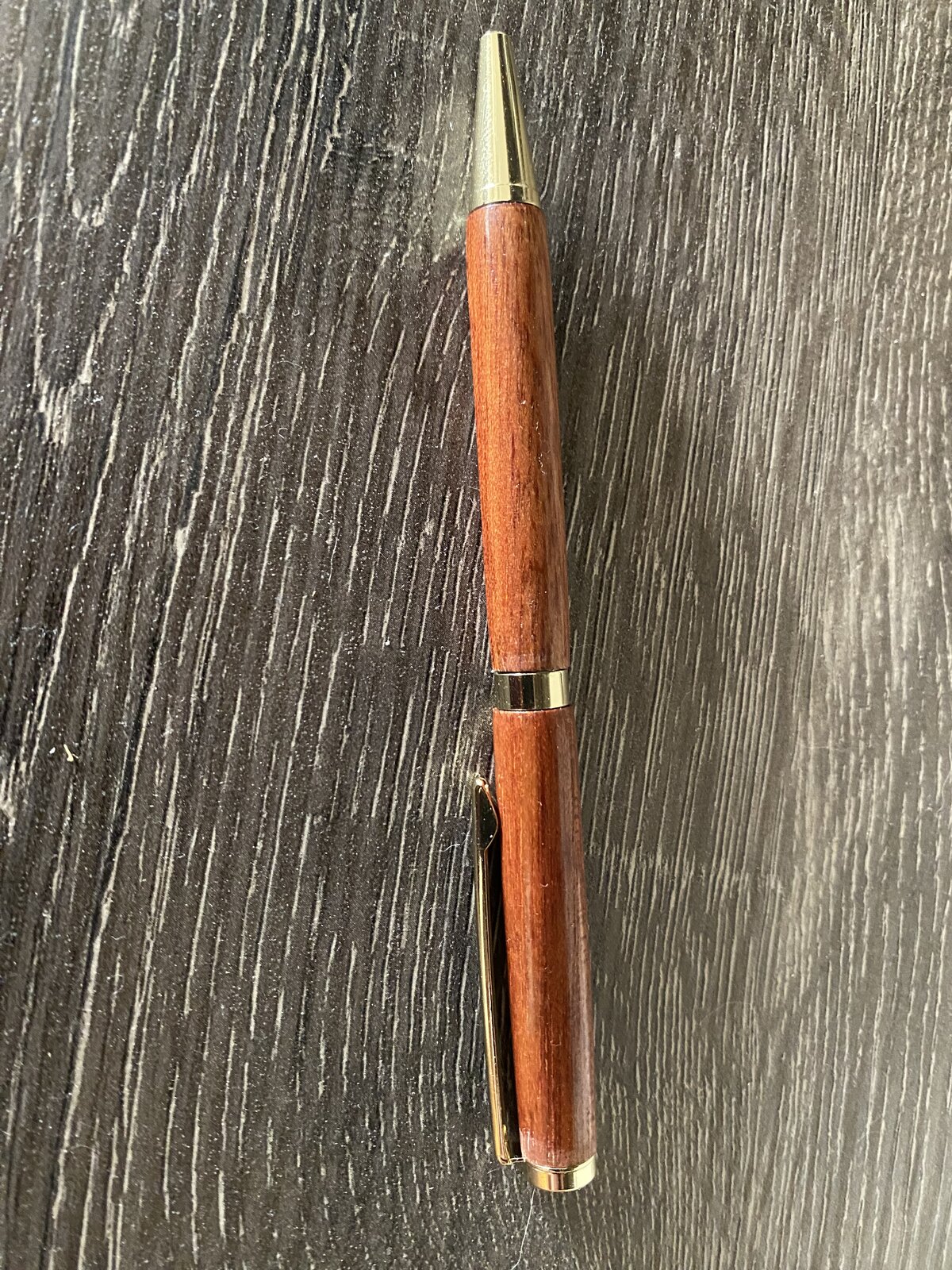

Not sure what that is happening by the clip with the white discoloration, did I get the CA too hot with the micromesh? There's other beginner mistakes I can see I've made, the second one seems to be doing a lot better as far as being close to the bushings and an even shape. I've been looking forward to doing this for a long time and I'm having a blast.

From your picture I can provide two possibilities that I experienced when I started turning. First, it could be sand through or else what I think more likely, is water penetration during wet sanding with MicroMesh.
Sand through often causes dull looking or grey areas in a CA finish as it is where the CA has been sanded all the way through down to the wood. It typically occurs from sanding the CA finish either too aggressively or by starting with too large of a grit. To conquer sand through, I stopped dry sanding the CA finish all together and went right to wet sanding with MicroMesh. I personally sand each grit with the lathe running at about 1000 RPM but only for about 15 seconds. Then I sand with the lathe off, with the grain, just one time around turning the blank by hand a full revolution. Finally, I use paper towel to wipe off any excess water and slurry from the blank before moving to the next smaller grit. The exception: I usually repeat the first grit because after the first time I still see quite a few shiny, low spots, in the finish. A second sanding with the first grit usually takes care of it.
The other thing it could be, that I think more likely from the way it looks, is water penetration during wet sanding with MicroMesh. Water soaking into the wood or getting between the wood and the CA finish can cause the CA to seemingly lose adhesion to the blank, leaving a cloudy like appearance on the ends like in your picture. To resolve that problem, I started sealing the ends of my blanks with CA before wet sanding. My regimen is to apply the CA using Non-Stick (conical) bushings, followed by lightly sanding the ends to clean up any CA buildup that goes over the edge. Some refer to this as a "fingernail" that gets removed. Then, to make sure that the ends are sealed up well, I put a few drops of thin CA on a small paper towel square blotter and press the ends of the blanks down into it. The thin CA seals the end of the wood and provides a very thin wrap around seal to the CA on the surface of the blank. Sometimes I blot each end twice, but usually I get by with just a single application to seal up the ends. After it dries, I put the blank back on the mandrel using my turning bushings and start the wet sanding MicroMesh process.

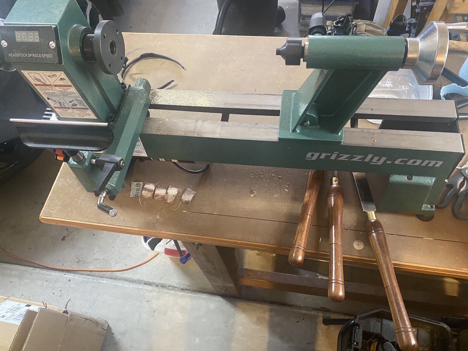

I looked at your lathe and noticed the on/off switch is located on the same end as the headstock. Mine is the opposite so to turn it off, I have to flip the switch and then reach across the lathe to slow or stop the headstock.

As far as the whitish spot, from what I can see (hard to tell 100%), it looks like the CA didn't adhere well to the wood. That, or adhesion was lost if, as Dave said, water got under it. That is a likely result of the wood swelling from the moisture. Also, the type of CA you use does matter. I started with Stick Fast and quickly learned that it does not make for a good finish.

Thank you for the response and advice, that finish was done using the CA glue that comes with the Rockler starter kit and no accelerator, so I'm pretty sure you're right and wet-sanding pushed some water in through a gap in the finish, or through the ends. The 2nd & 3rd efforts from the kit did not have a repeat occurrence.
