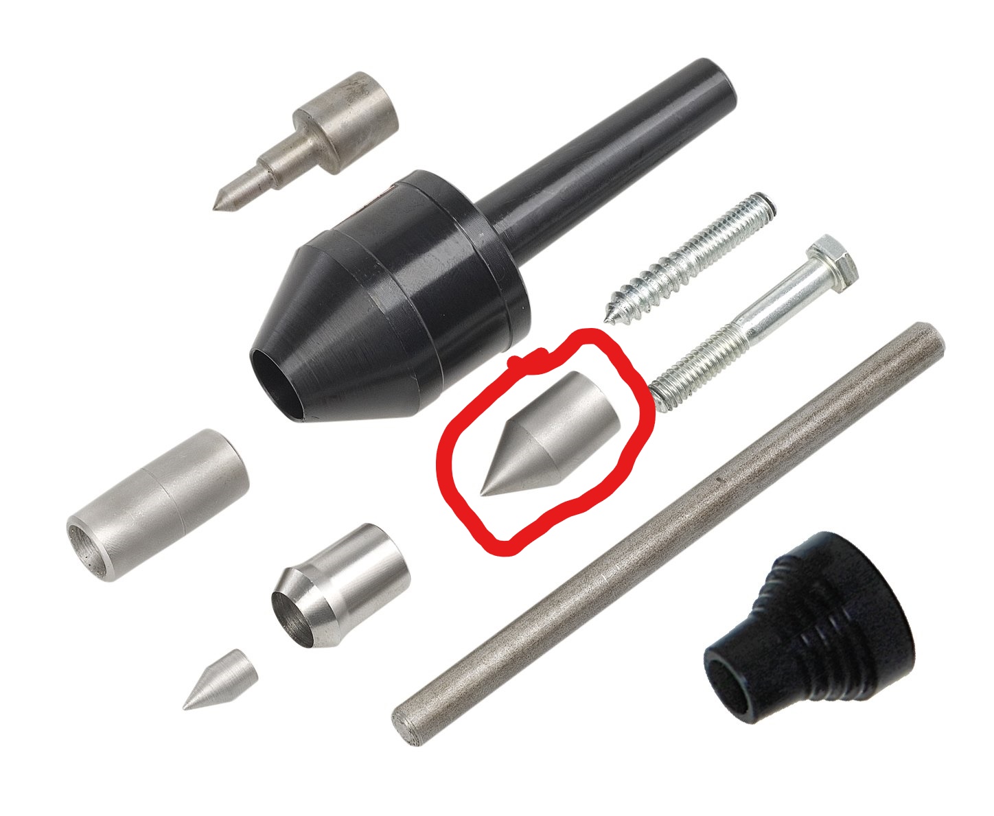

Good Morning,
I am looking for a replacement 60° centre for my Nova 2MT Live Center System SKU #210005 MFR #5015.
Does any one know where I can get a spare?
Thanks.
monophoto
Mar 13, 2010
2,546
Saratoga Springs, NY
Assuming that the manufacturer can't supply a replacement, I suspect that you are looking at a custom machining project. Contact Rick Herrell.
magpens
Feb 2, 2011
15,911
Canada
I agree with Louie.
Contact the manufacturer and ask if they can provide.
If not, then Rick Herrell might be able to make one for you.
The part that you have circled in red has the 60 degree taper on the "business end" and the other end has a much shallower taper which will have to match the internal taper in the big black part. . . I have one of those sets and that's the way mine is. . I assume yours is the same as mine.

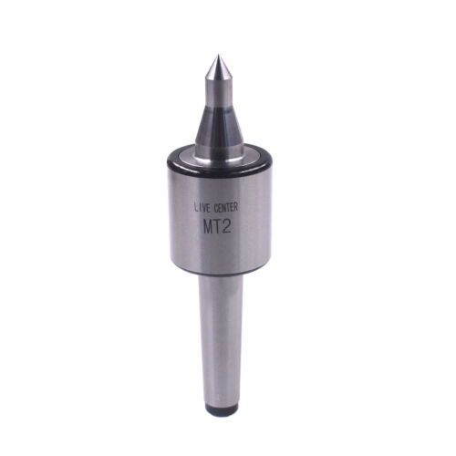

Those inserts have proprietary tapers and will be next to impossible to find. The next best thing would be to buy a regular 2mt live center, you can buy one of those cheaper than what a machinist would charge to make that little piece.

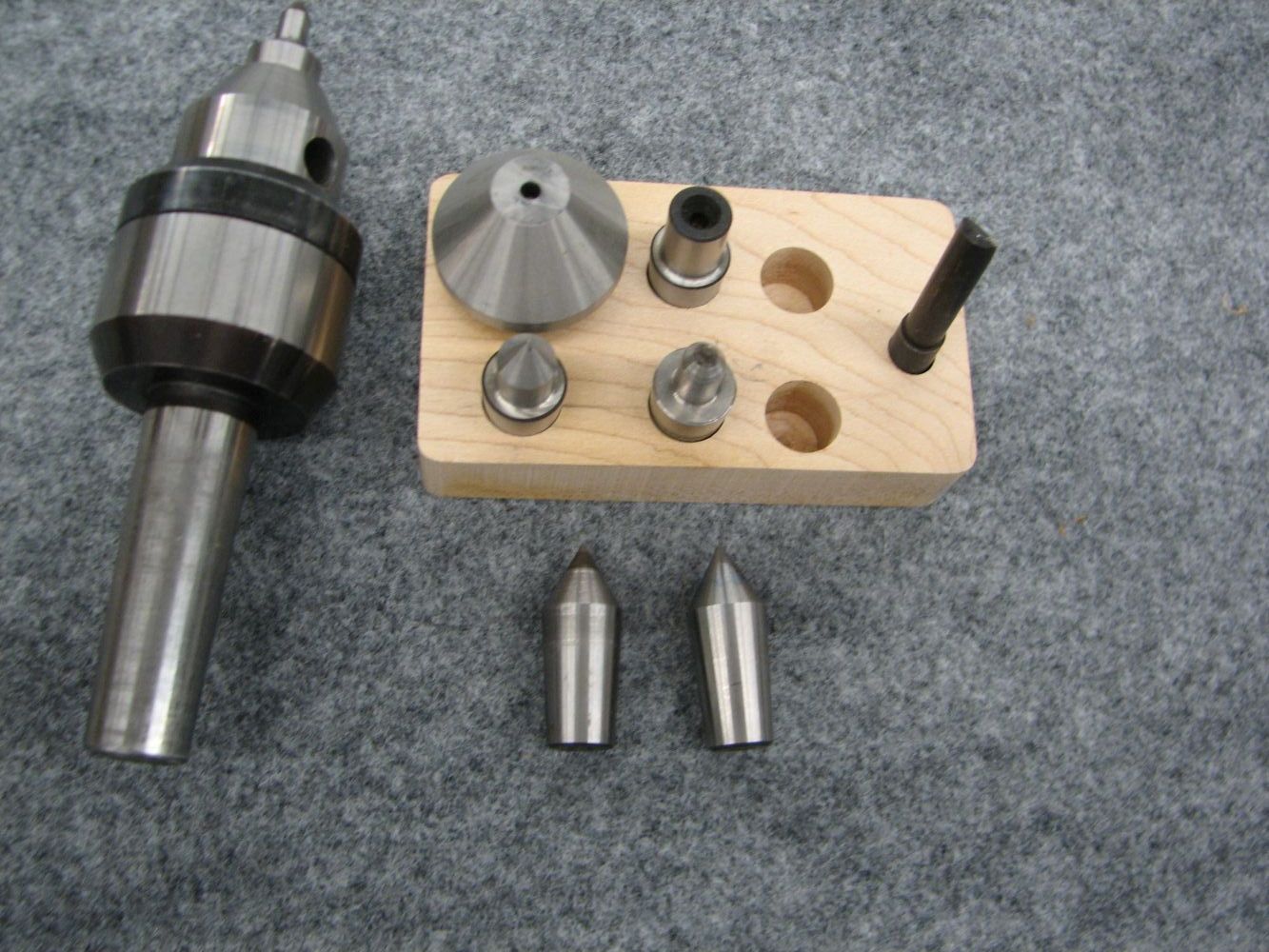

This might be your lucky day! Your post sparked a memory and sure enough, I found this hidden away in a drawer...
On mine the small diameter is about .437" and the large diameter is about .527". I have TWO, one is 1.362" long and the other one is 1.345". You're welcome to one of them, just pay shipping.
