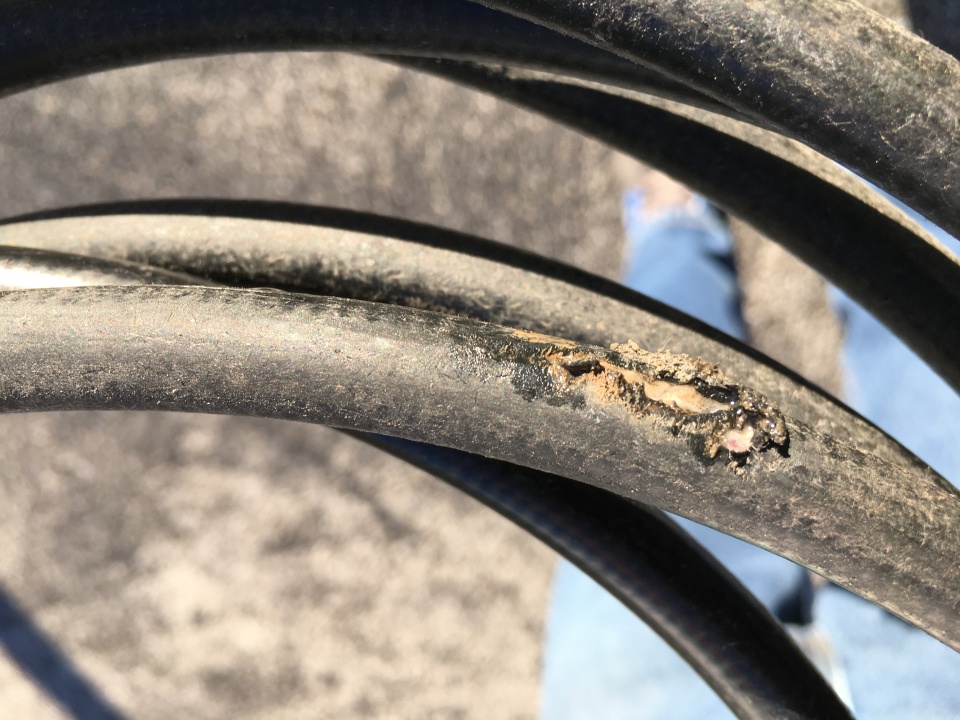

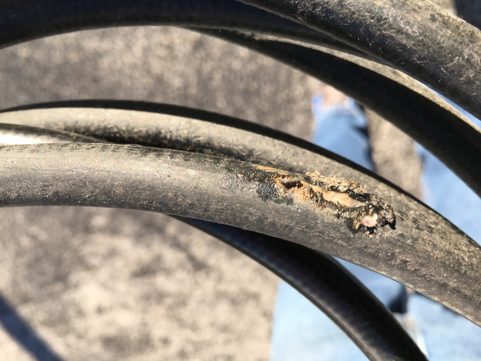

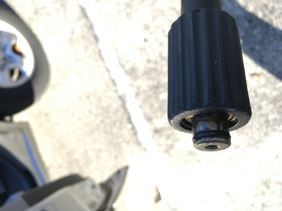

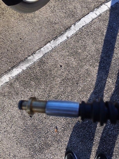

Here's the item. Karcher wants $90 for the hose. The entire unit was $165. Hopefully the line can be fixed.

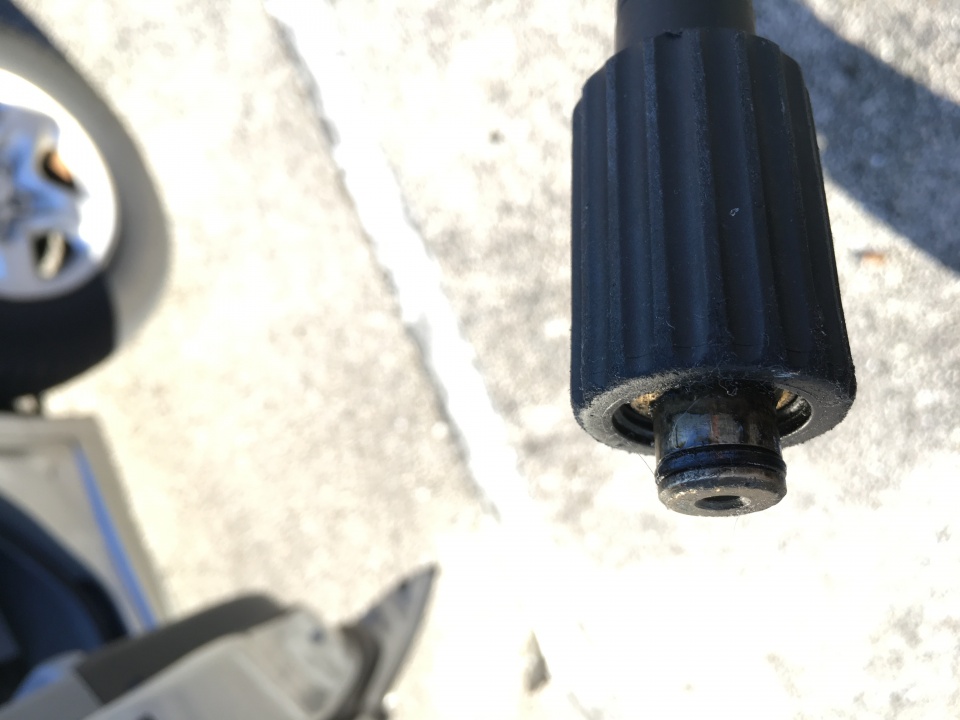

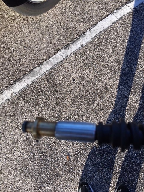

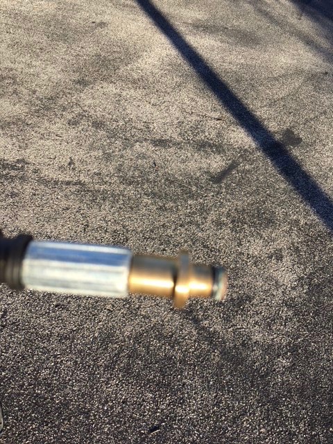

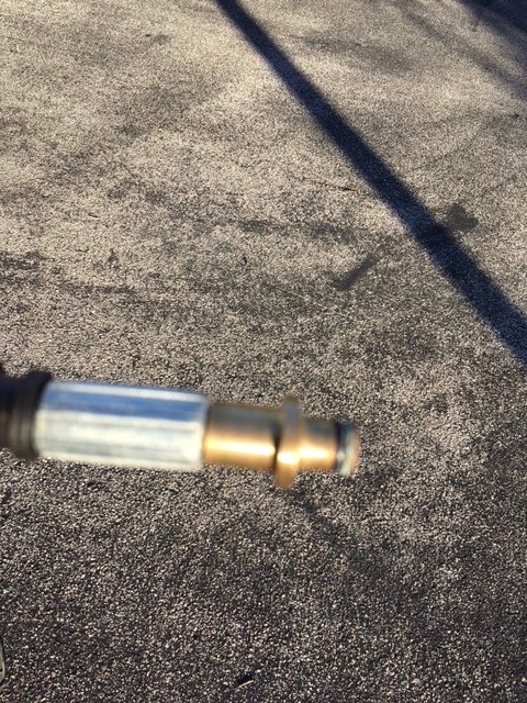

Not such great pictures. Is this a standard fitting or made for Karcher?
The other end in the post above is an M22 (I think).

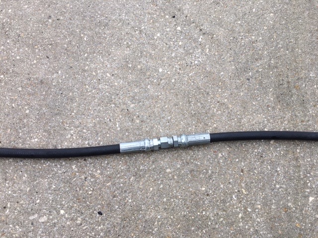

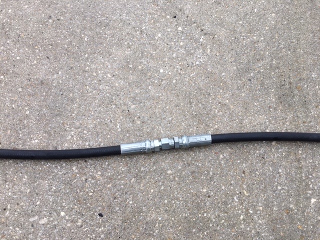

Thank you very much for your replies. It steered me in the right direction. Found a local shop that specializes in repairing Hydraulic/Pressure lines. While you wait service.....reasonably priced. $16.
