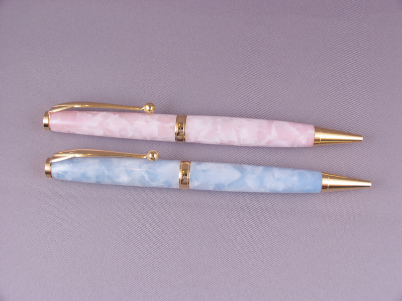

Michael; Check out this article on pen blank preparation. Note the section on how to drill and cut acrylic blanks. When the drill bit breaks out of the bottom of the blank, it often leaves stress cracks behind.
Acrylic blanks should always be painted on the inside of the drilled hole. I use a rattle spray can. Just two Fssst down each end of the tube and let dry overnight.
You can change the look of the blank with different colors. These two pens are the same blank, just one is painted with baby blue paint, the other with hot pink.
View in Gallery
Pits can be filled with Medium CA. Do Not sand the blank prior to filling the pit or sanding dust will leave a white spot on the blank.
Hope this helps.....
