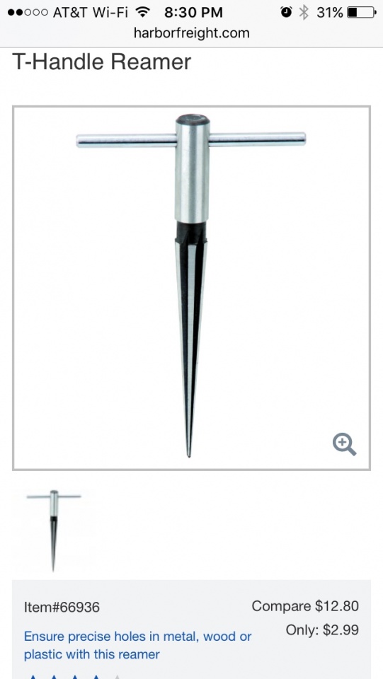

I sometimes get a burr that rubs against the transmission when turning. It happens mostly on Majestic Squires. I use a tapered reamer with a few twist into the threaded hole for the transmission. Smooths out the action. The tapered reamer is wonderful for cleaning out the tubes before assembling. IMG_1035.jpg
