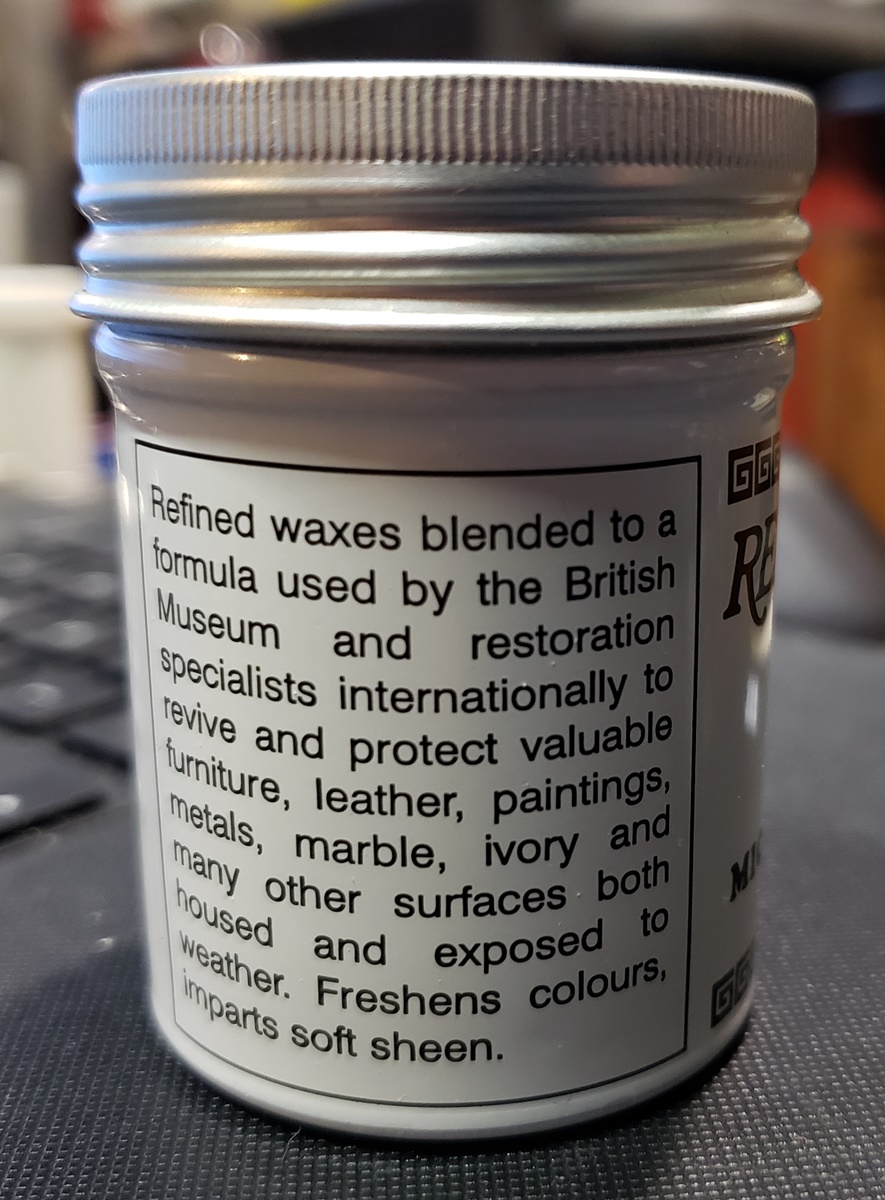

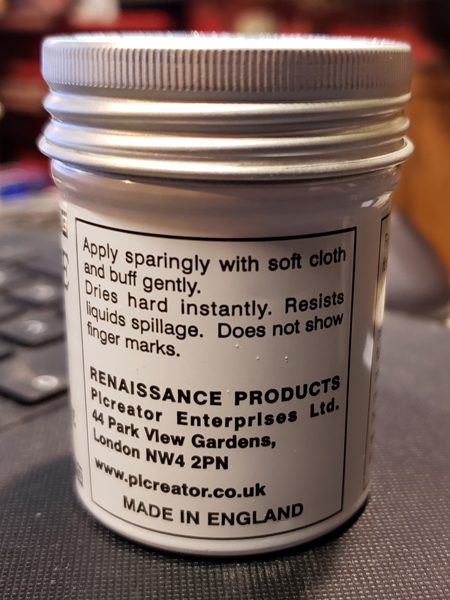

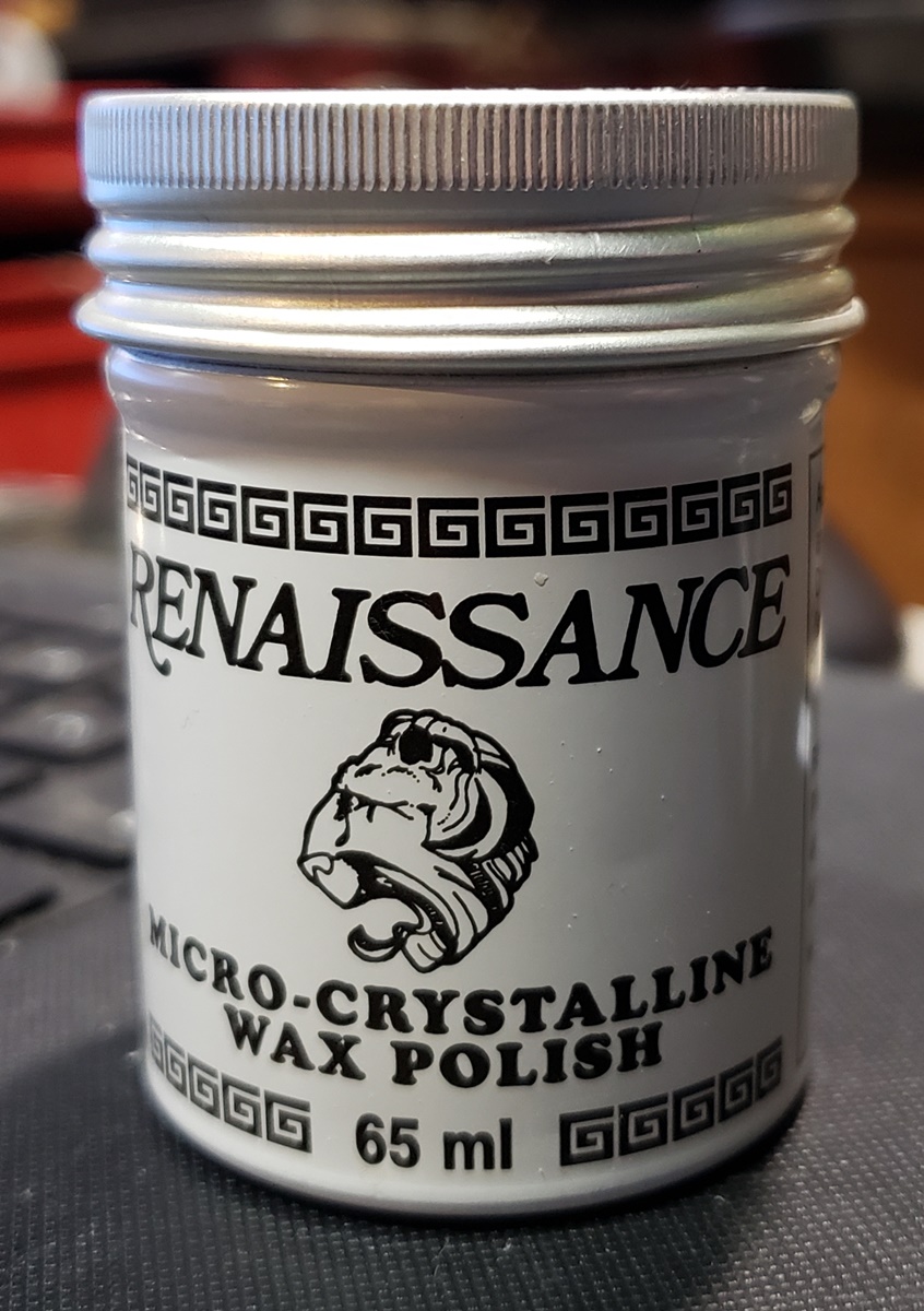

Can someone remind me what the purpose of Renaissance Wax is? I've only ever tried it once, and it just made a mess, but I don't remember the details. Those of you who use it, how exactly do you apply it?

I simply take a piece of folded up paper towel, apply a very small amount to the paper towel, and wipe it all over pen in a thin layer. Then, I take a clean paper towel and buff the excess off.

As mentioned in posts above, apply a sparing amount by hand. Wipe off immediately, before it has time to dry for best results. Using the same cloth to apply, and buff off. It does deter finger prints and body acid, as well as bring out the shine. I don't know what else it NEEDS to do.

That's probably its major quality. It was developed at the British Museum Research Lab in the 1950s in the search for a better coating to protect metals from tarnishing than common waxes made from beeswax and carnauba wax at the time which either contained acids or became acidic over time. It's a microcrystalline wax refined from crude oil and is more stable than other waxes over time. It provides good anti-tarnishing properties to both wood and metal surfaces, and as such, it also provides protection from fingerprints.
If you use it, it should only be applied as a final coat to the blank and metal surfaces of a pen to help protect the metal parts and the blank. It only takes a very small amount and even a small can will last a long time. I just apply a small amount with a paper towel, wipe it all over the pen, then use a clean, wadded paper towel to hand buff it off. Lots of good suggestions in this thread on how to apply it - pick the one(s) that appeal to you and give them a try to see what works best for you.

Thank you for the suggestion, but I already have a 65ml can of Renaissance Wax.
