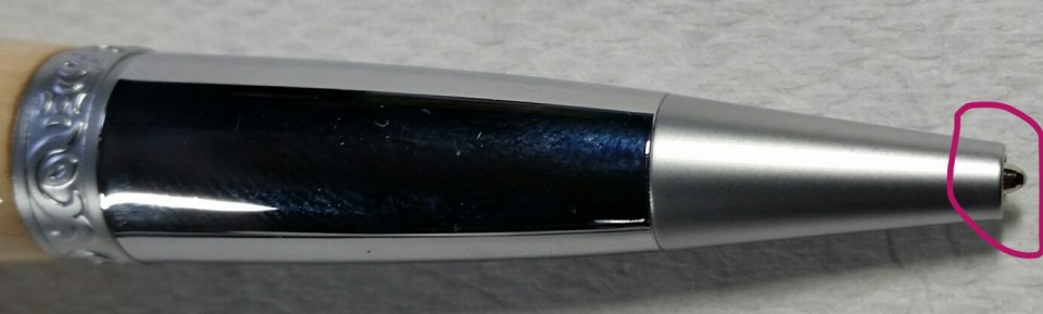

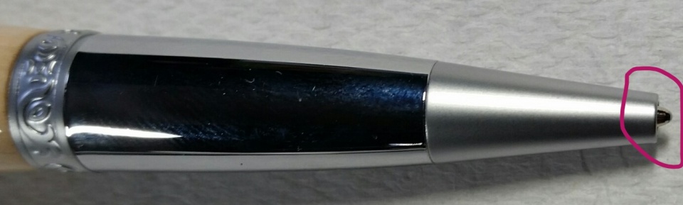

Thanks all; here are some pics. I think the finial simply threads on to the clip retention ring assembly and the transmission is engaged by rotating the barrel. This is different from the other Sierra types that I have made. Oh well, I got to get the transmission out of there. I don't see how can without damaging the transmission. Thanks again!

Way different design than the instructions show for that pen. Understand the conundrum of disassembly with the photos.
Disassembly will probably be with a pair of captured plates and screw jacks rather than punches and mallet.
I'd say you should be able to easily push the trany out by pushing from the top.
It is a friction fit and should be easy. I'm also guessing that for some reason the trany assembly came unscrewed from the lower section. Look in the lower section that holds the nib and see if you can see threads inside on the upper end. You may need a magnifier and flashlight to see in there.

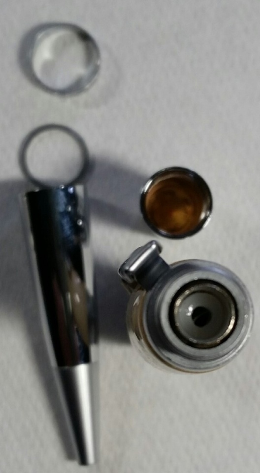

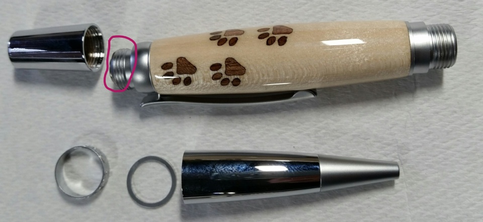

This looks like one I have apart. Let me get a picture of it and re-post.

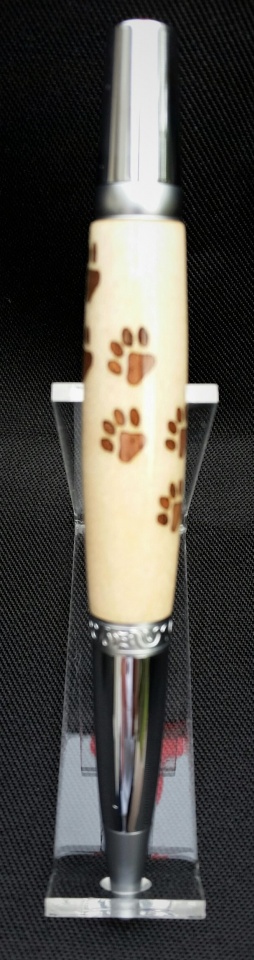

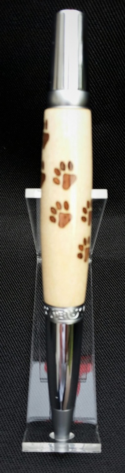

Thanks Ken, Dale, Larry, et al ...that is what I am talking about (i.e. instructions incorrect). I just got it to work. Believe it or not, I beat the heck out the transmission being willing to sacrifice it and it still worked fine. I had to use 150 grit sp on a mandrel (attached to a drill) and reduce the inside diameter of the tube. That's is after I clean the inside of the tube with a fine rat's tail file yesterday, chamfered it, and hit with 600 grip sp just for good measure. Evidently, that was not enough. I am not into "ranting" a vendor (especially for a $8 kit), but one shouldn't have to do that to get a pen to work. Any way, my beautiful wife, Lori, is enjoying the pen now. Here's one of my "classic" horror pics (even Lori said they stink :-), and getting worse! ). Thanks for all of "yous gizes" help. (Italian- Brooklyn for y'all) .
