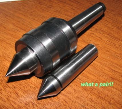

If I wanted to turn between centers instead of the mandrel for applying the CA finish, which centers would I need?

Hi dabull. I'm a newbie so take a grain of salt, but I believe you need a dead center in your headstock and a live center in your tailstock (you almost certainly already have a live center in your tailstock, but you may need to get a dead center for your headstock).

And make sure the live center in the tailstock is a 60degree live center, the stock live center that comes with most mini/midi lathes can't be used for this with how the tip is configured.

After experiencing the same tear away on my finishes, I went with the turning between centers approach as well. The little machine shop (littlemachineshop.com) has #2MT dead centers for around 6 dollars. I think I paid more for the shipping than the actual dead center.
