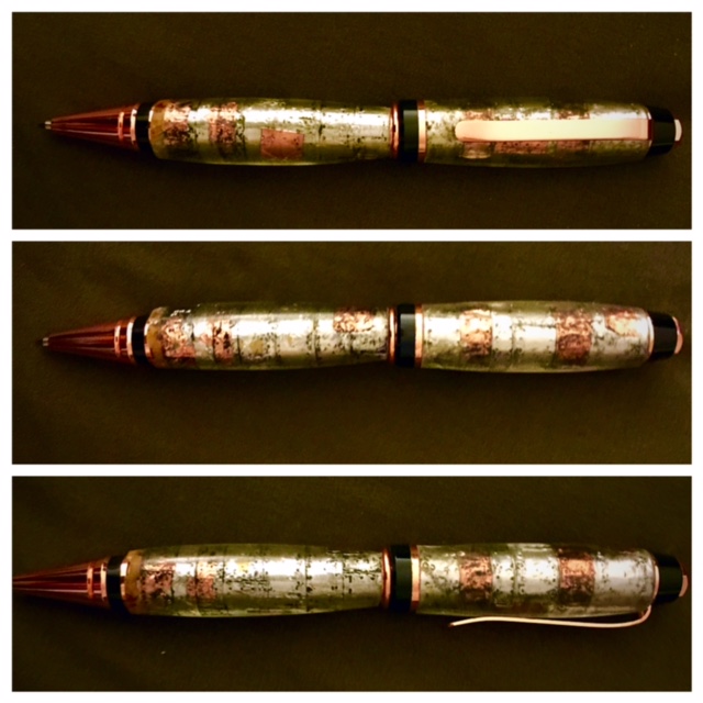

Went home last night and beat the hell out of the PVC and it eventually came out. I am using a Michael's boxed set of PR. I will try the cooking spray next time. I can't wait to get the silicone molds. Here's the finished product. My first Steam Punk pen I posted it on face book late last night and got two orders right away! I guess it was worth it.

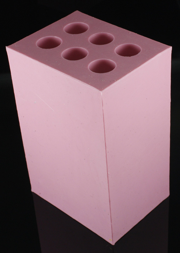

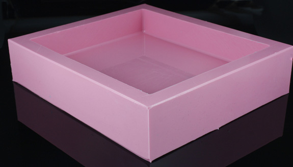

For those of you having trouble with PVC and want to make your life easy...you need one name. Fred Wissen, aka PtownSubbie. His Silicon molds are THE best!
he has a 6 hole 3/4 vertical round, and a 6" square mold if you wanna cut them up...and a hundred in tube molds!
PTownSubbie.com - Silicone Molds
