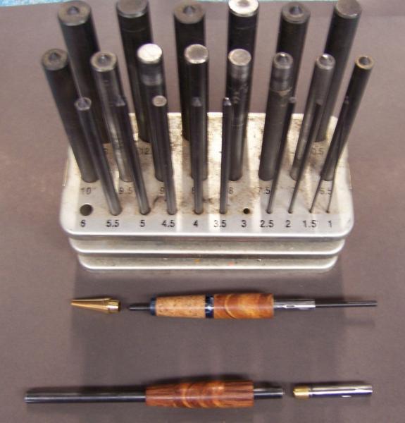

Here is a photo that might help! use a 3mm punch for the nib and 6mm for the Transmission :biggrin:

The HF punch set has the one you need. I have never found a pen that I could not disassemble using the HF transfer punch set. John has been busy today taking apart pens and showing how its done. Thanks John.
BTW: John is from Australia...a metric system country. The metric system is so much easier.

You still need to get you a set of these. It will be the best 10$ you ever spent for anything to do with pens.
An 1/8" anything: rod, hanger, nail, welding rod,about 6" long will work for the nib. A 1/4" for the transmission. Eventually you'll treasure the investment(about $9) the HF transfer punches. Good luck
