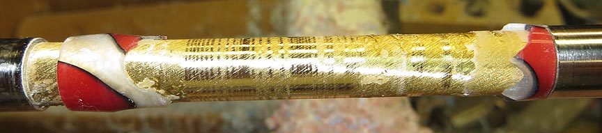

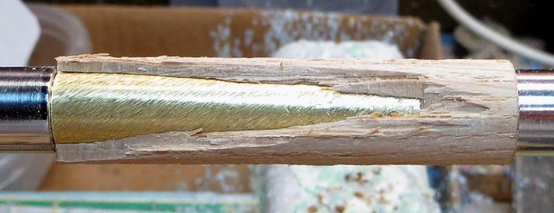

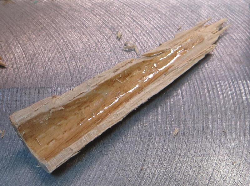

Paul -- Stripping the remains of a blank off the tube is a good technique to learn because it can be a learning opportunity. I use it as a way to check my gluing process. When a blank does not work out -- for instance, the turned down inside of a blank does not redeem the expectation, I often turn to the blank off to see how my glue coverage is doing. If I find chunks coming off that were not attached well with glue, I have information to use to evaluate what I have been doing.
If you start making euro style pens -- many will have you turning to the tube to form a tenon for the center band and doing that well makes for a better pen. Turning to tube can be a practice opportunity for future tenon turning.
While some turn down for tube recovery alone, I suggest you learn from the process and get some information along the way. Find excellent glue coverage, give your process a big check mark.

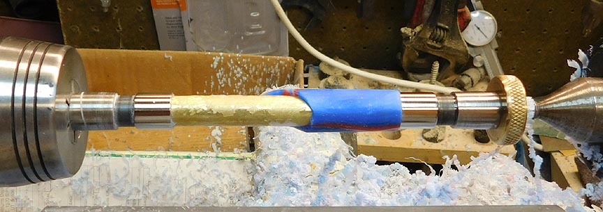

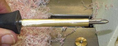

It's best to use bushings when turning the wood off the tube, the kind that goes into the tube, especially if you are turning between centers. You can make them from hardwood if you have to. The amount of force required to hold the tube while you turn off the wood will flare the ends of the tube slightly unless you're way more lucky than I am. When I flare them I put the tube in the chuck and use a file to bring it down to specs. If you don't do this the flare will push all the glue out the blank leaving very little to glue the blank to the tube causing much gnashing of teeth and pulling of hair later.

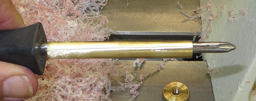

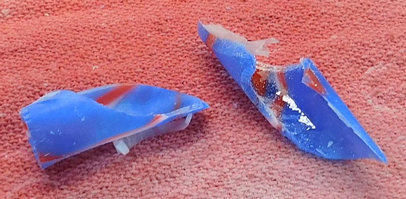

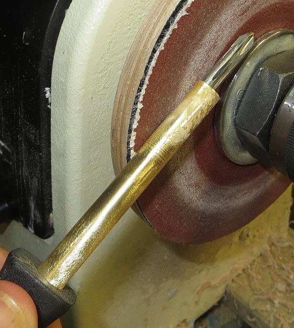

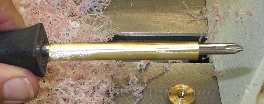

Yes. It went very easy. Once it started to splinter I grabbed a knife and pulled off the rest. It was good to see the blank sticking well to the tube as it took me a few minutes of prying away. I used sandpaper followed by acetone and then sanded a little again to clear off the acetone.

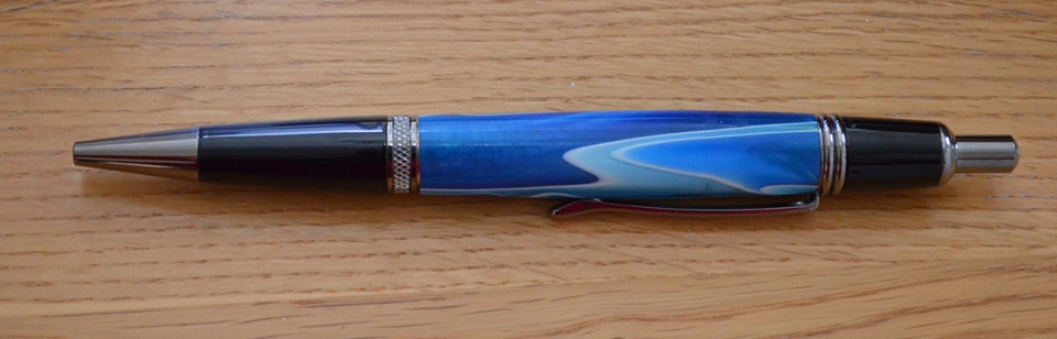

Completed pen. Used a square carbide tool to finish but had chatter at times and there was a rough spot on the acrylic blank which never smoothed.
