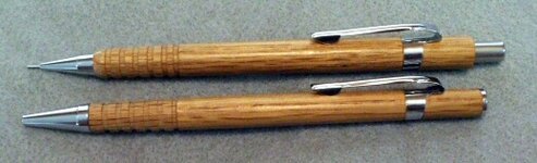

I prefer the Pentel pencil, so I made a slimline pen to match. Used the longwood style, with the division of the top and bottom at the top edge of the top finger groove.
txbob
