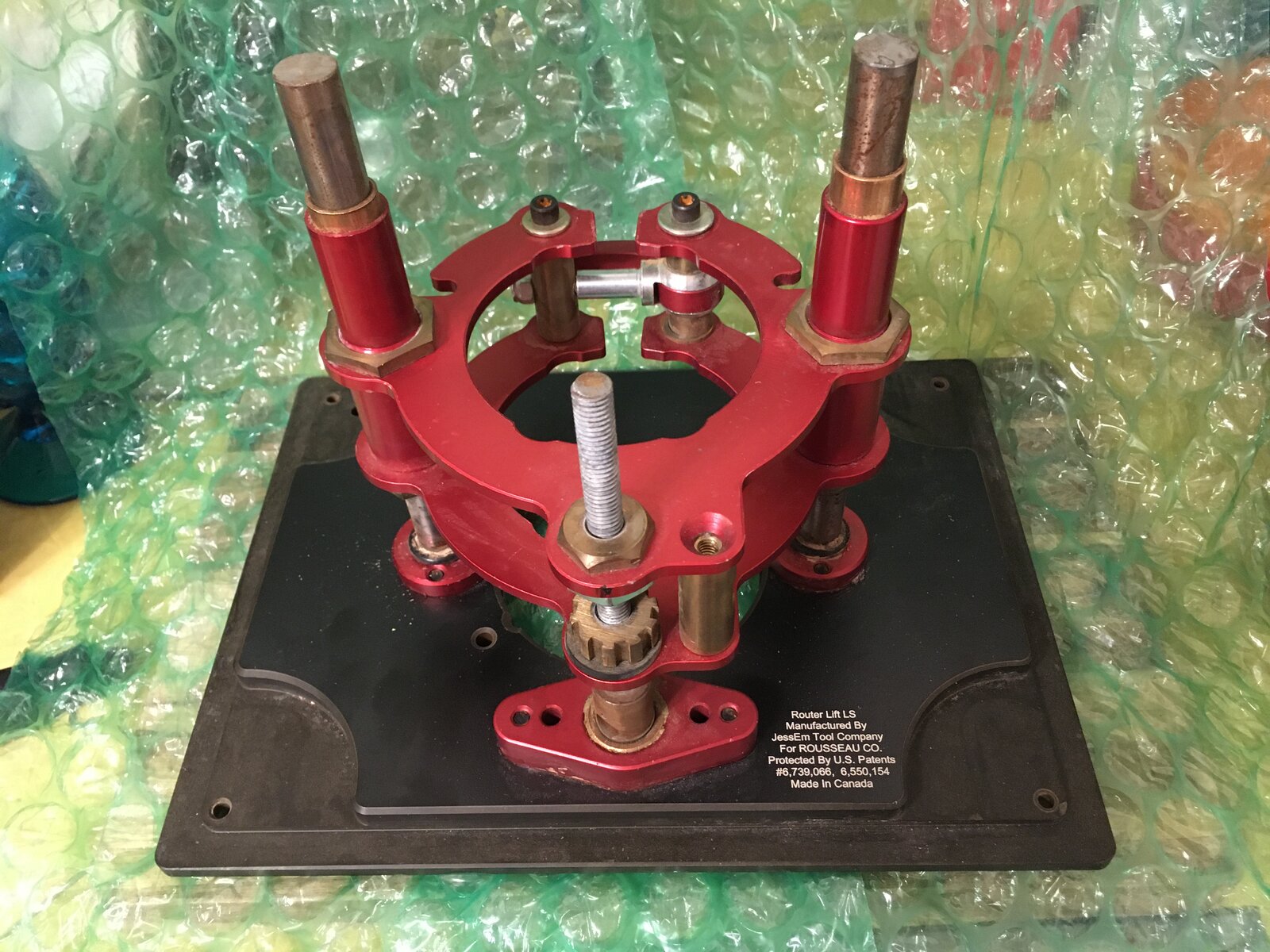

Just got this older router lift off ebay for just over a hundred and now that I've seen it up close I'm feeling good about the deal I got. Although it looks rough you can hardly feel the little bit of rust on the posts and the height adjustment is butter. I originally thought I would break it down completely but I don't think that's necessary now. I'll probably just give it some oil and go with it. Out of necessity I'm having to mount it in the middle of a melamine top shop table. I know it's not the most stable setup but I'm not planning on doing anything extremely accurate with it anyway. I should be able to compensate with support from underneath well enough. So questions are...
Any general advice on rehabbing this?
