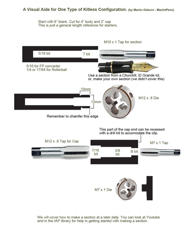

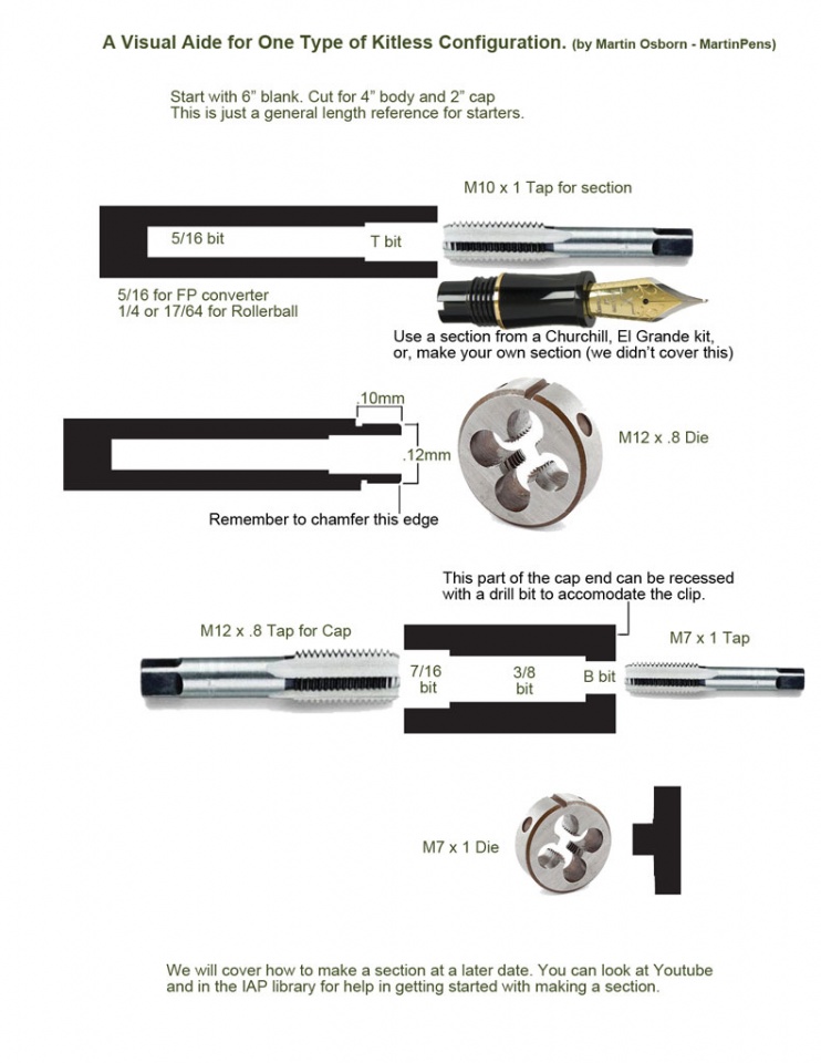

Here is the visual for one type of kitless pen making. It's not complete (nothing about making a section or how to do the cap clip) but it's a start.
You can download the .pdf or use the .jpg for reference.
