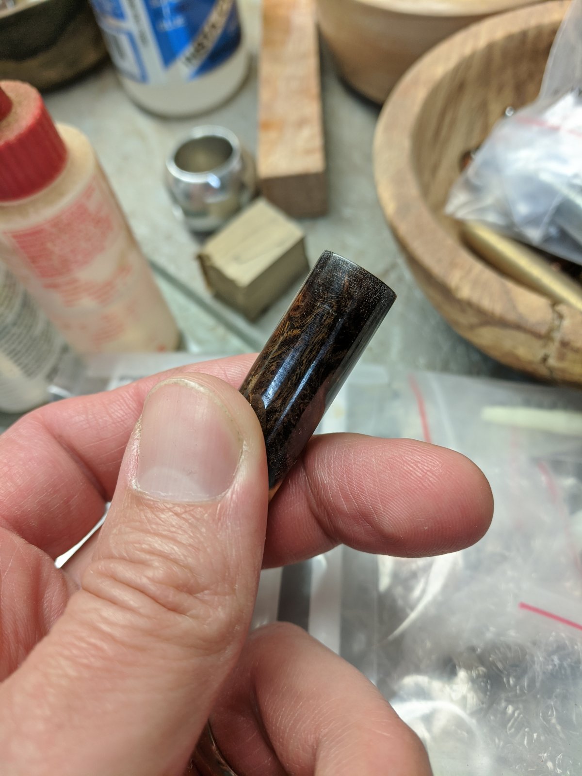

In case anyone is curious and following along attached is a photo of the last one that I refinished today. You can see some hairline cracks that are visible to the eye. There is also a slight haze across the entire finish. All of the pens had the haze on the surface and a few had the visible slightly larger cracks
