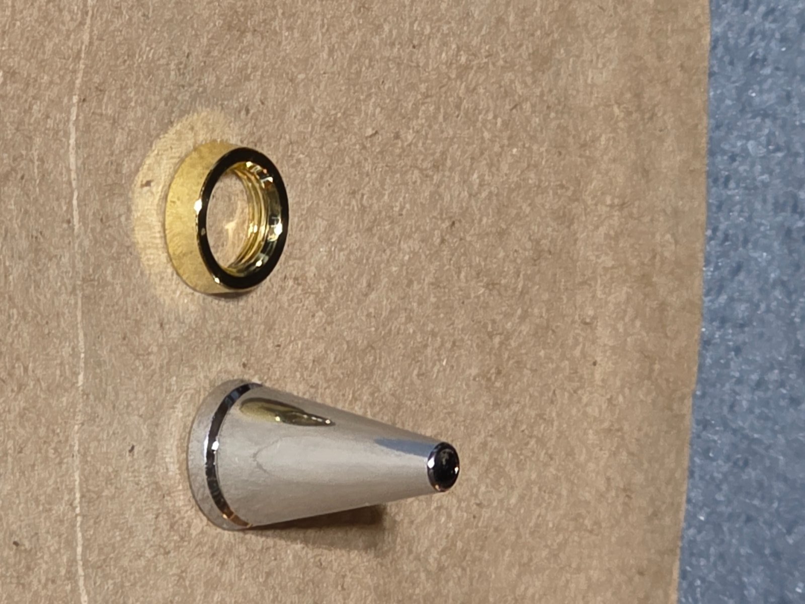

I had this problem a few years ago on two or three Cigars. I don't know what caused it. I solved it by removing the ring that sits above the nib and screwed the nib back on. The refill then came out to an appropriate length. I don't know if it makes any difference, but my Cigars have all come from Penn State.
