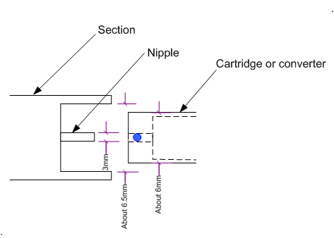

My understanding is that the dimension that critically defines 'standard international' cartridges is the ID of the opening at the end of the cartridge that inserts into the pen section. There is a male nipple inside the section that inserts into the female channel in the end of the cartridge, with the cartridge held in place by the friction between the nipple and the inside walls of the channel. The best information I have found is that the ID of that channel is 3mm. Whether the cartridge actually seats against the bottom of the recess in the back of the section isn't all that important. Also, the outside of the cartridge doesn't have to touch the inside of the section, but obviously the cartridge must fit inside the recess in the section.
The OD and length of a cartridge are only important in that the cartridge must fit inside the body cavity of the pen. I've seen international standard cartridges with various shapes and lengths.

Allow me to give more detail on international standard cartridge/converters and how they attach to sections. Admittedly, it's hard to find good information on this subject, but as far as I have been able to determine, the really critical dimensions are depicted in this drawing.
The important point is that the cartridge/converter is held in place by friction between the nipple inside the recess on the section, and the walls of the channel in the LDPE cartridge or converter. That nipple has a 3mm OD, and the channel in the cartridge is the same diameter or microscopically smaller so that the plastic grips the nipple. The diameter of the cartridge, and the diameter of the recess in the section aren't important as long as the cartridge fits inside the section recess. On the pens that I have measured, that diameter is around 6mm, but the dimension can vary between designs.
The overall length of most standard international short cartridges is 35-38mm; standard long cartridges are about twice that length. The cartridge may narrow slightly at the open end, but this can vary between manufacturers.
The other interesting aspect is that there is a small glass or metal bead embedded inside the channel in some (but not all) cartridges that seals the cartridge at the factory. When the cartridge is installed in a pen, the nipple inside the section forces that bead back into the cartridge reservoir, opening the channel so that ink can flow into the pen. The bead then serves as an agitator to break up surface tension in the ink so that it flows toward the nib when the pen is held in the nib-down orientation. If the design of the cartridge does not include that bead, then the nipple must actually break through the plastic at the end of the channel. Some converters also have built-in agitators.
