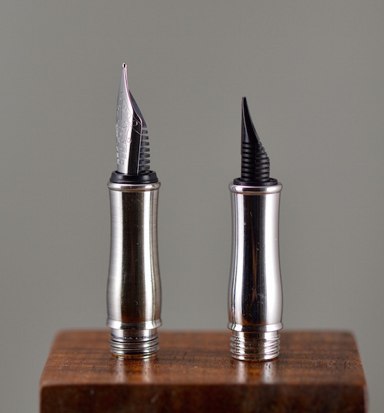

Update on my project to refinish "Front End" part:
I judge the effort a success. (To review; PSI does not offer a FP kit in Antique Pewter for the Nouveau Sceptre, only RB. My customer wanted FP. I said "sure" before realizing PSI does not offer the FP. Hence, the challenge to modify a FP front end to match the Pewter pen selected by the customer)
Pic #1: (Left) reworked front end. Notice the subtle radial lines. Rather than a flaw, these were necessary to match the "factory" antique finish that has these lines. The appearance was achieved by mounting the piece on the lathe and very carefully, at SLOW rpm, abrade the surface of a rhodium plated piece, using 400 then 600 grit. I was careful to not blow thru the plating. This was followed by 3 clear coats of Protectra, an Everbright product. You can also see another mod. I substituted a Schmidt feed/holder and polished nib. The feed holder had to be altered to fit the PSI hardware. (The unmodified Rhodium plated piece on the right is shown for comparison.)

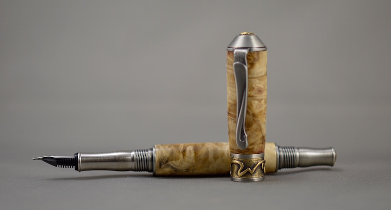

Pic #2: A view of the modified front end mounted to the pen. There are slight appearance differences observable compared to the "factory" finish on the rest of the pen, but these variations are slight. The pics seem to accentuate the differences more than looking at it hand-held. I asked someone to inspect the pen and tell me if he noticed anything odd or off with the pen. Answer:No. My observer could notice minute differences only after I made known the modification. My buyer only knows that I was going to provide the pen to him as a FP instead of RB as it was displayed on the sales table.
I am pleased with the results of the modification. The "antique" nature of the target finish, with intentional slight variations in the surface, is the only reason I even attempted to do this: it is a forgiving finish to copy or match. I trust the topcoat from my prior experience with it. At this point, the customer is happy, and I breathe a sigh of relief and satisfaction. IT WORKED!! :biggrin:
