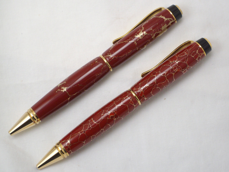

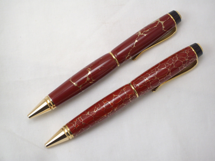

I made two pens to compare the difference between these two blanks. I thought the Matrix pattern would be too large to look good on this pen, but I really like the way it looks.
The Web looks good as well.

I'm not edumacated enough to know which is which, but on that body, I definitely prefer the one on the left. Both look great though.

Both are great. Interesting centerband treatment. Care to elaborate on it? :)
EarlD
Thanks for the nice comments.
The centerband treatment isn't original with me, but here's how I do it:
  1. Cut a custom lower tube the length of the standard lower tube plus the black ring that goes just above the nib of the standard cigar pen. PSI has the 10mm OD tubes. 2.220 inches is a good length.
  2. Use the standard lower tube for the upper barrel.
  3. Throw the black ring, and the top tube and the trim ring for the black center band into your ever-increasing pile of spare parts.
  4. Use the standard nib end bushing and the standard clip end bushing, and two lower barrel middle bushings back-to-back.
  5. Turn and shape to your desired profile.
  6. Pull the two bushings out of the center and replace with two smaller diameter bushings (either two nib-end bushings, two clip-end bushings or one of each).
  7. Cut and round the center end of each barrel to your desired shape.
  8. Finish the barrels.
  9. Take the black centerband and cut the flange off it. I use my metal lathe. Some folks use a Dremel with cut-off blade. There may be other ways to do the same thing.
  10. Completely assemble the lower barrel including the transmission. The threads in the nib are deep enough to make up for the black trim ring you aren't using. Plan on using adhesive on the fittings.
  11. Press the black bushing you have created by trimming the black centerband into the lower end of the upper barrel. Without this bushing, the barrel will have too much movement around the lower end of the transmission. This bushing will not need adhesive.
  12. Check for fit onto the lower assembled barrel.
  13. If the fit is not OK, use a round file to make the bushing in the bottom end of the upper barrel larger.
  14. Once the fit is OK, assemble the remainder of the upper barrel.
  15. Admire your handiwork.
I know what you mean - I think half the reason I made both was I couldn't remember what the customer wanted, and then I had to look at the suppliers site to make sure which was which when I went back and looked at his order, after I made the pens.
FWIW, the web is the smaller pattern and the matrix is the larger pattern.
