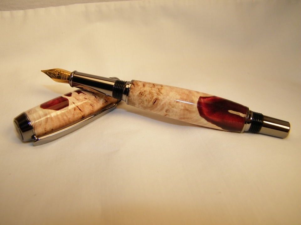

Here's pen #14. Amalgam mutt blank from beartooth, Navigator FP kit from Woodcraft. C&C welcome.

Nice finish! is it CA?
Thanks. Yep it's medium CA.
Paper sanded through 600. Then about 6 coats or so of medium CA. Then wet sanded with micromesh through 12,000. Then about three coats of HUT Plastic Polish.
Those amalgam mutt blanks are beautiful. Interesting that the CA soaks into the wood part, but lays on top of the alumilite part. Takes a few coats to build up to even, at least for me. Thanks for looking.
