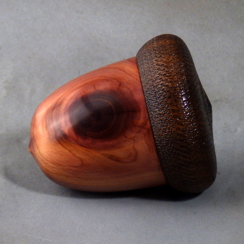

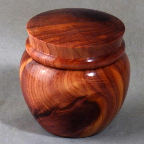

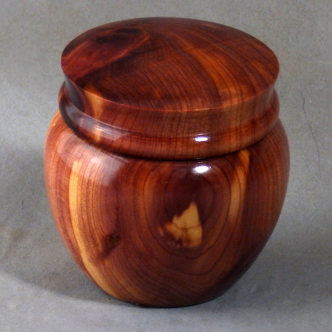

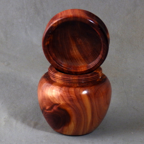

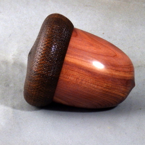

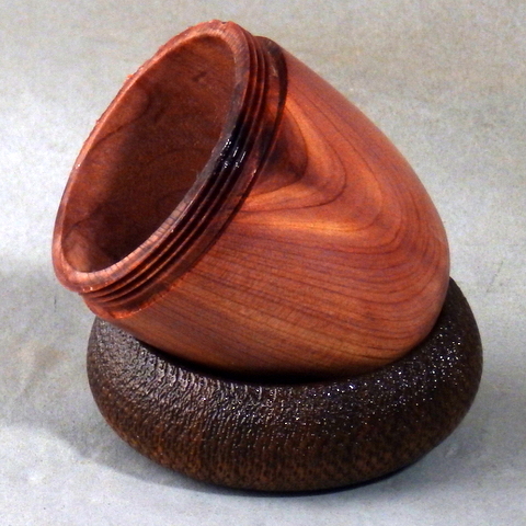

A friend of mine from church had a red cedar that needed to come down, so he asked me to make some things from it. It had sat around after it came down long enough that it had cracked pretty badly, but I salvaged enough from it to make a lidded box, and the body of an acorn box. The top of the acorn box is black walnut.
The lids on both boxes are threaded.

Size - I didn't take a 'scale' picture because these didn't go on Etsy. I often take a picture with a soda pop can because everyone can relate to that size. The lidded box was about 2-3/4 diameter and about the same height to the bottom of the threads (if I recall correctly). The bottom of the acorn IIRC was about 2-1/2 inches in diameter and the cap was about 3 inches in diameter.
Threads - I use the Chefware Kits EZJig for threading and these are threaded at 16 TPI. Red cedar requires a lot of CA for stabilization before and during the process.
