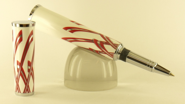

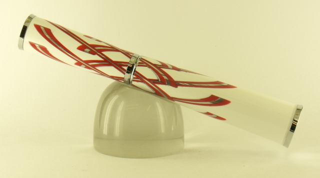

Here's one I did today (on a couple of days leave :biggrin: )
Chrome Panache kit with red/ali/red feathers. 6 in one direct, 6 in the opposite. Here's how I did the cuts and made the hole
It does have a few flaws, but I think it's quite pretty all the same and I like it.:biggrin:
I hope you all like it too.:smile:

Always love seeing anyone's version of Eagles Feathers, but yours are tops for being done completely different than Eagle did it.
Yep Roy, he did leave us with a few tricks, didn't he? Have you spotted the other trick that he did very often too, that I used here as well? I'll tell you in five minutes...:wink:
Eagle always loved to completely hide the original blank from the masses of random feathers, but I've always preferred the 'less is more' approach. :smile:

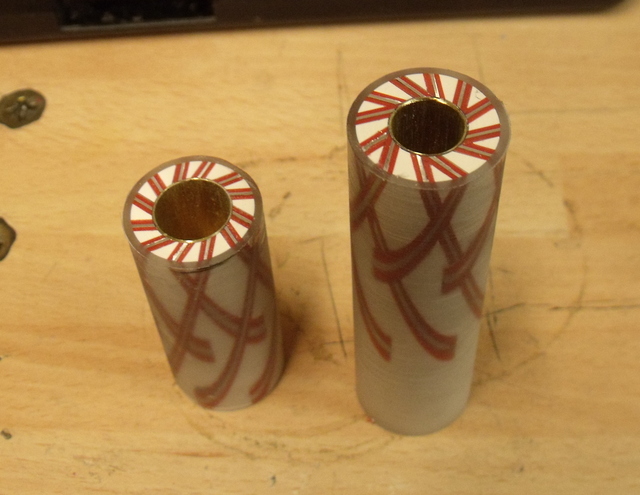

Ok Roy, your 5 minutes is up!! When Eagle did his intricate glue-ups, he would use loads ( like a whole bottle!! ) of CA over the blanks so that he could drill down the middle without it blowing up. He sometimes used gauze as well. I was trying to get him to use a boring head, but as you know, he didn't have a lot of money.
