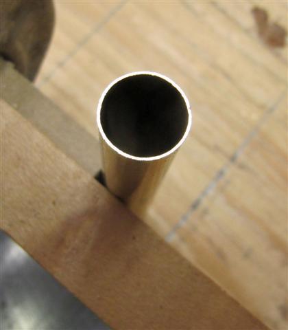

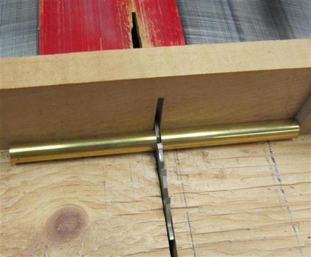

I cut all my tubes to length on the TS with a thin kerf blade just above the top of the tube. I use a sled to hold the tube.
attachment.php
attachment.php
Works for me!
