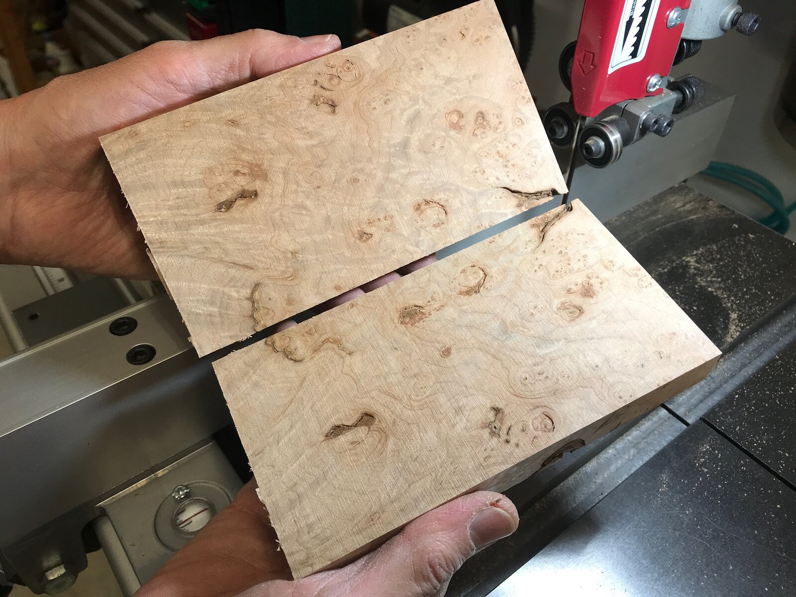

  • Timberwolf 1/4" 6PC, click the link for the details. This is, for me a great general purpose blade, it cuts through everything I have fed into it like butter. I even did a little resawing of some maple burl that was almost 3" thick and handled it very well (pic below). I was too lazy to swap blades to the one below, but it did a great job and the blanks were beautiful.
  • Woodslicer 1/2" Resaw, click the link for the details. This blade is an absolute cutting beast. It is guaranteed not to fail at the weld. Mine did, and Highland Woodworking shipped me a replacement immediately with no hassle. If you are making straight cuts or very gradual curves, it rocks.
