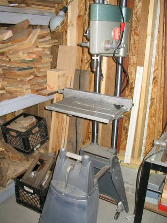

I've got a WEN benchtop which I got online (Amazon, I think). It replaced a Delta which I had for quite a while. Both are/were variable speed via a Reeves drive. I really like the idea of a no belt change variable speed and this guy is (was) in your price range. Other than paint and some minor features they're close to identical.
I just checked Amazon and there are several WEN models to choose from. Take a look at the 4210.

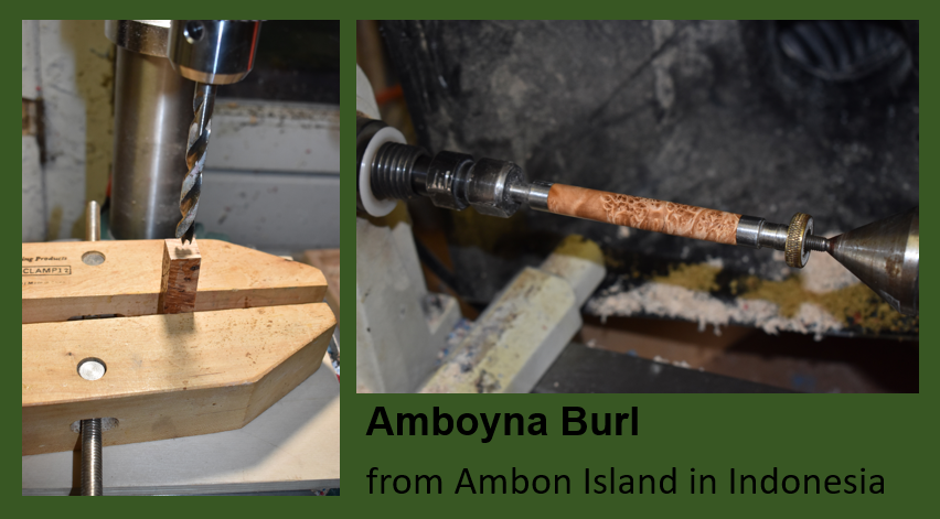

I have all the extra stuff anyway and many here do also. IF someone doesn't have the chucks, fittings, etc, it is going to cost anyway to get a VERY good blank clamp to bring about the same accuracy that drilling on the lathe will.
Nah.... not expensive at all for a good clamp. And if need be... you can put a V channel in for good measure.

You made me laugh! 😊 You are right about that clamp for you and the experienced. But that is only for knowledgeable woodworkers or machine shop folks. I have seen too many blowouts and questions as to why - through the years. That clamp has too much surface area exposed directly to air around it for the inexperienced. Most blowouts in drilling (with the inexperienced) happen with V-channel clamps anyway.
I understand. My query is on blow outs... and how many you have. Makes me wonder on your technique... When drilling blanks. Do you go down a short way... then bring the bit back out to clear material? If you don't clear the hole... go down... come back out... go down and come back out... clearing as you go... the material bunches up and creating pressure... which is the cause of most blow outs.
Preacher Jon, You may be misunderstanding something. I don't have blowouts, what I am addressing is the different reasons blowouts occur and how to prevent them. You apparently haven't read of the continuous blowouts that different ones, (most new turners) have over the years. My answer is to those inexperienced with blowouts and what causes them. There is no one single answer.
Clamping is only part of the problem for people having blowouts, and in some blank cases, clamping is impossible so wrapping with gauze and CAing the gauze keeps the integrity of the blank intact. These have to be drilled on the lathe. The type of clamp that others use is important also. There have been a couple of machinists here who have made blank clamps that were hugely better than commercially sold ones.
The thickness of the wood itself and the diameter of the drill bit also affect it. It isn't uncommon for someone to have a uniquely beautiful blank 3/4 in square and the pen kit requires a 1/2" bit. Simple clamping as you mentioned is a recipe for a blowout. Normal clamping as you mentioned on a 3/4" blank "might" work OK for a 3/8" bit.
