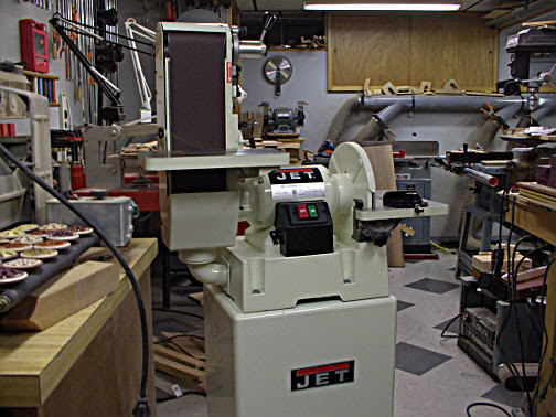

Have to say I was looking for a 12" disc sander a few years ago also and decided to step it up and go with a floor model and glad I did. I got the 24" belt and 12" disc Jet sander and actually use the belt more than the disc. If i need disc i usually break out my Delta 6 " desk top unit because I hate changing paper on the larger one and I have so much paper for the smaller unit. But the larger belt has saved me many times.

They are pricey but you get what you pay for and if accuracy is what you need you will pay a little more. I do not remember what I paid for that one. I am sure I got a deal on it. Someone had to be running a deal.
