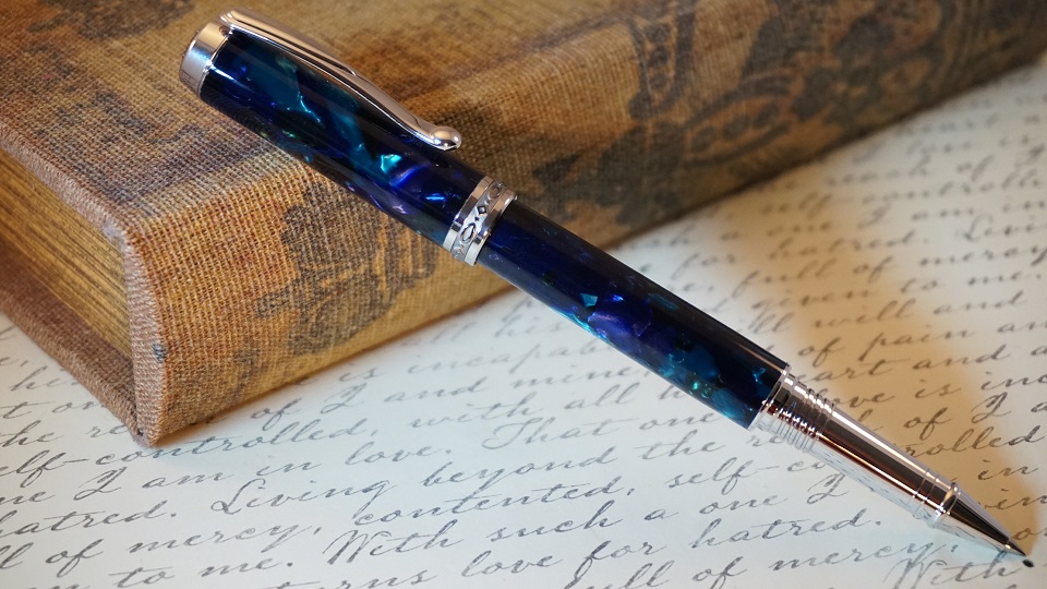

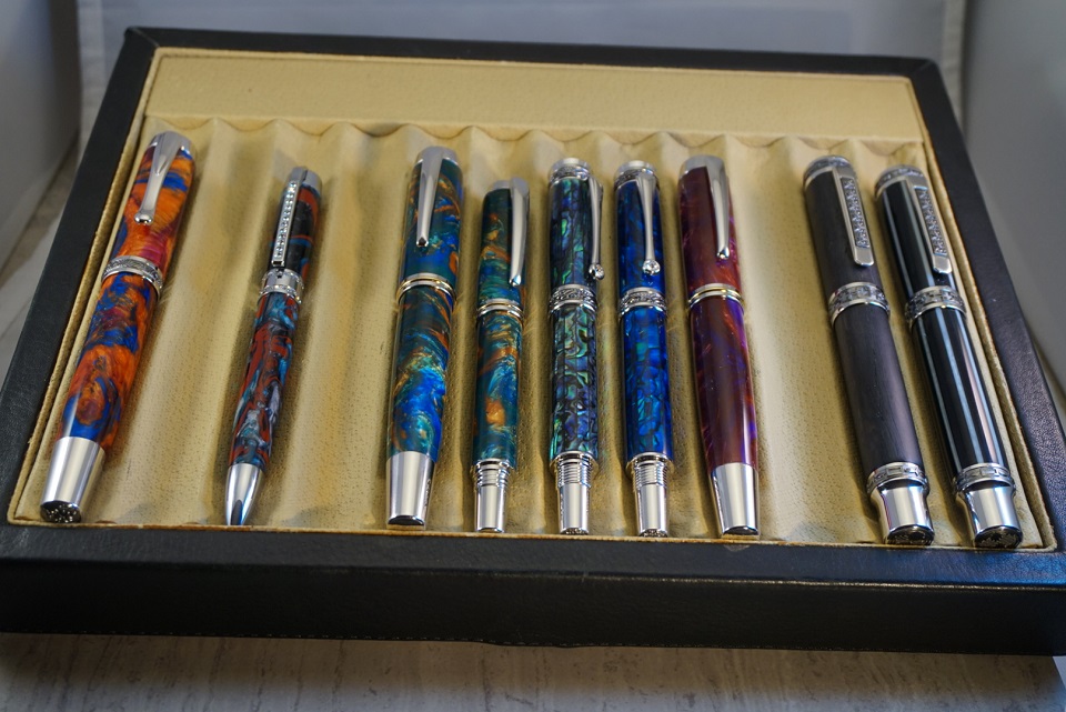

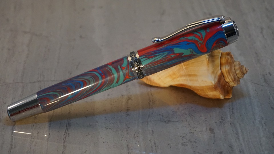

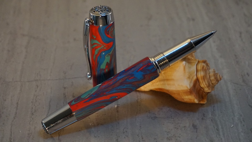

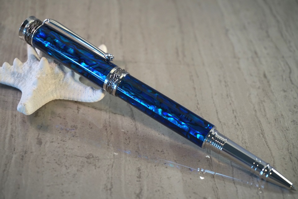

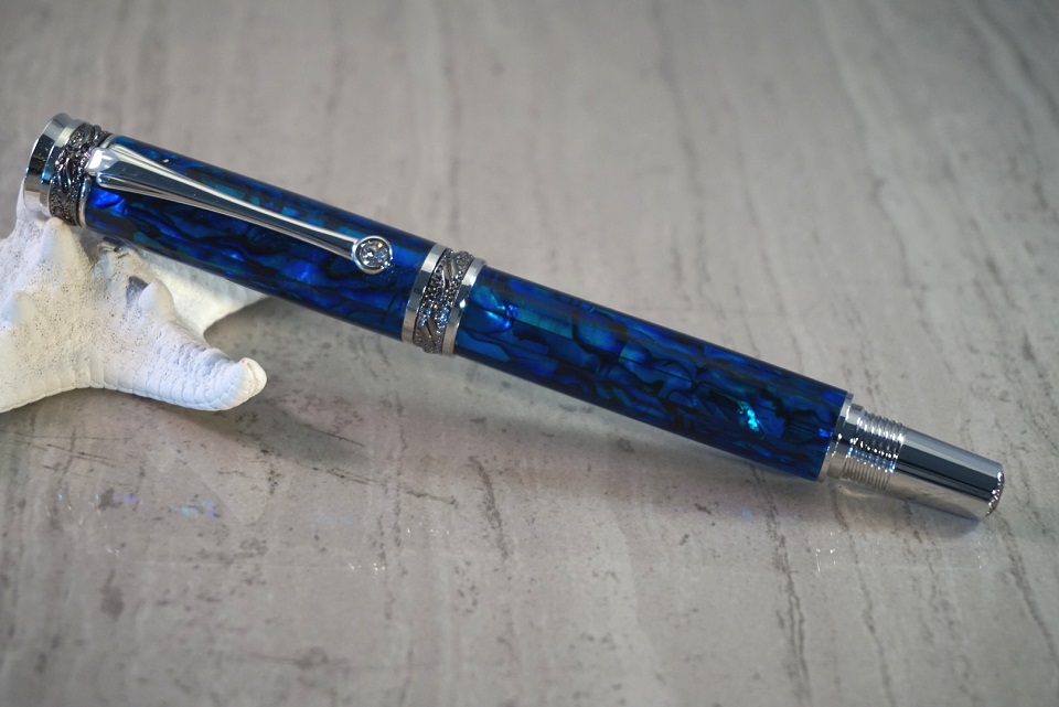

Hi Everybody,
I haven't posted much lately. I've been busy with the new house and a couple of big jobs. I received an order for 13 Statesman Rollerballs in Monoswirl Avocado for a hotel in the Cayman Islands, and put together a display for a gallery in Santa Fe. There have been some regular sales since then but I have finally been able to make some pens for the heck of it.
First up is the Gallery Order:

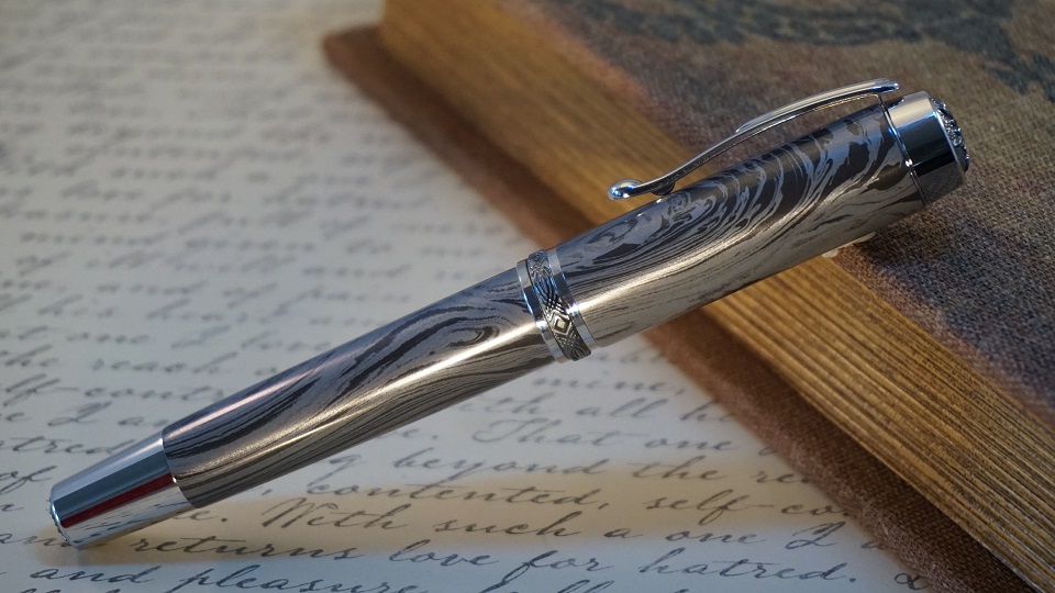

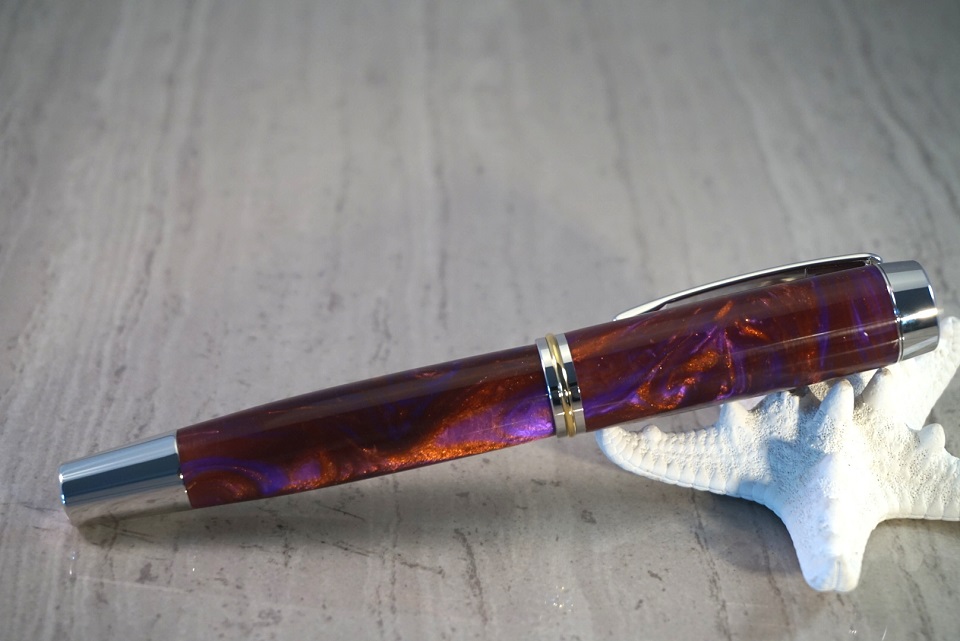

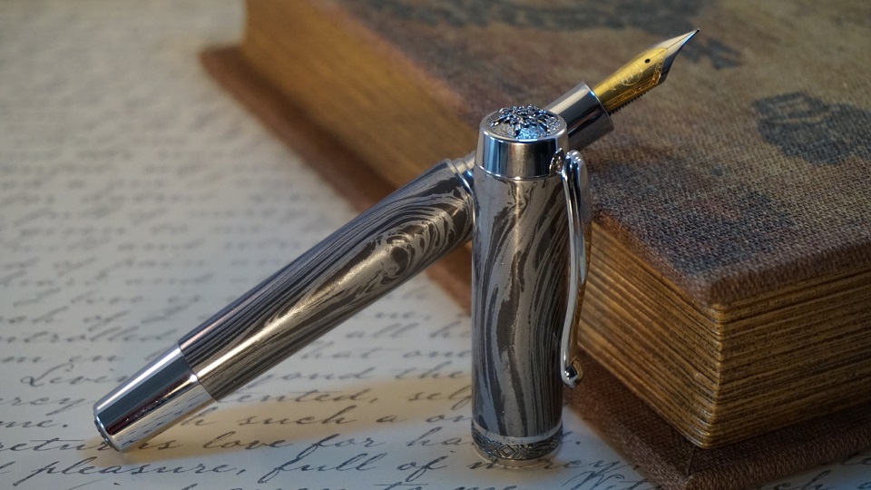

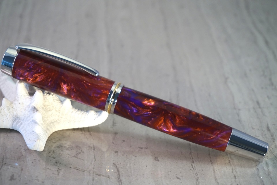

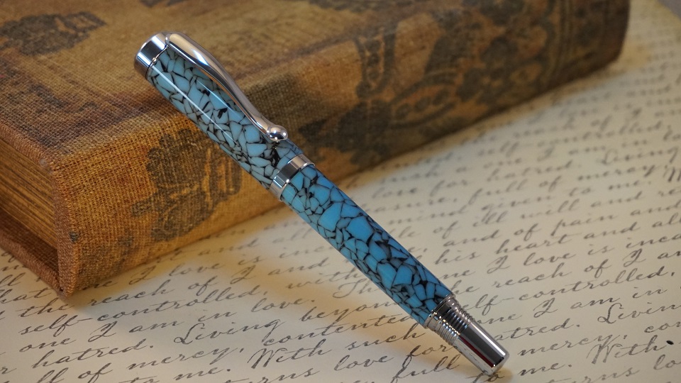

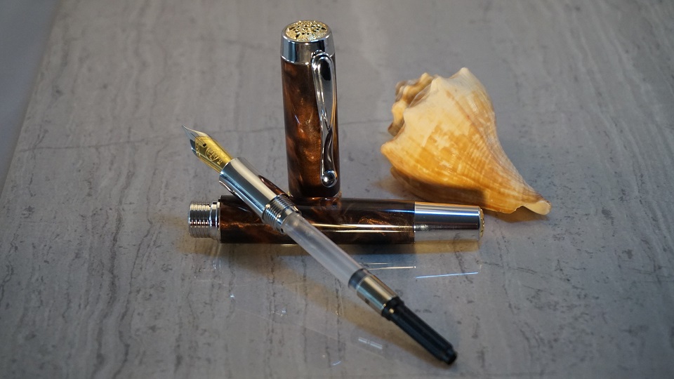

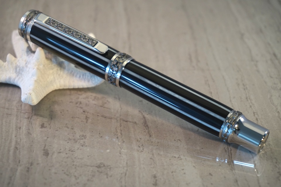

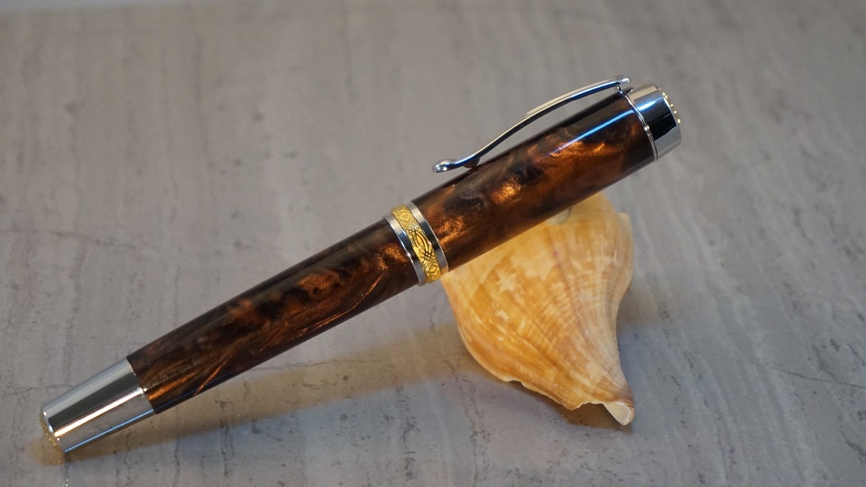

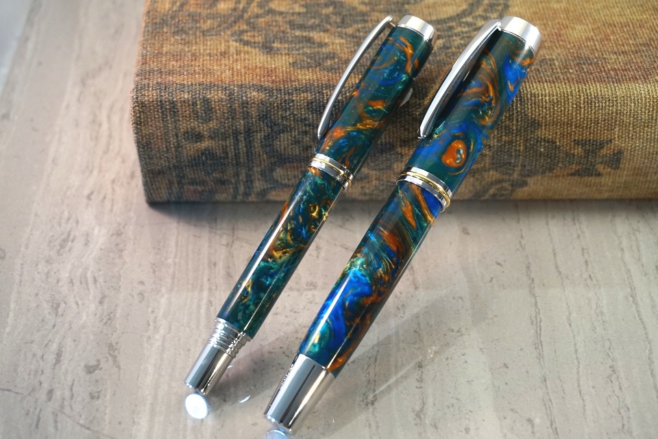

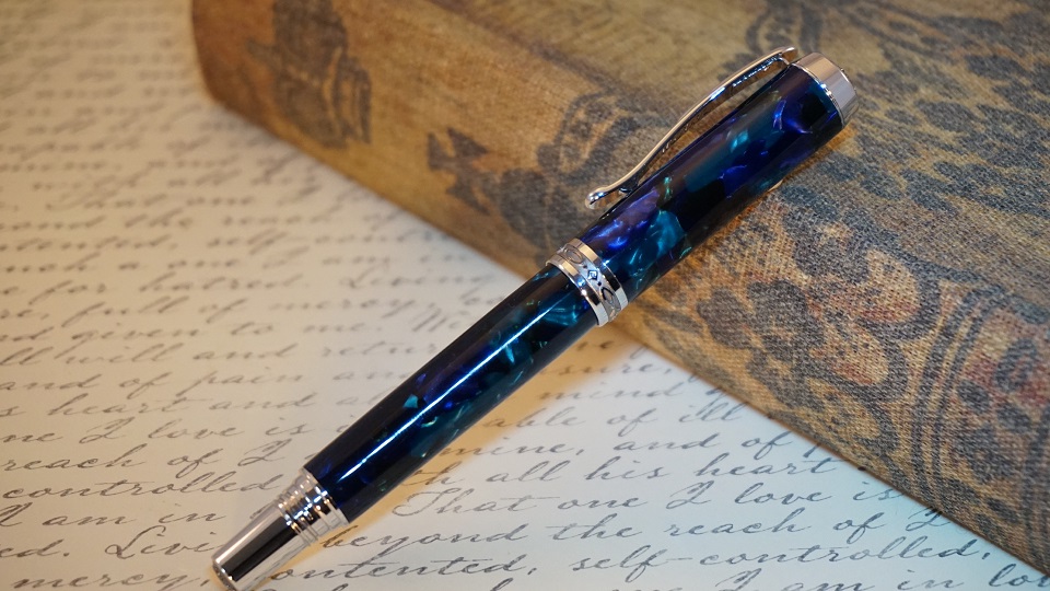

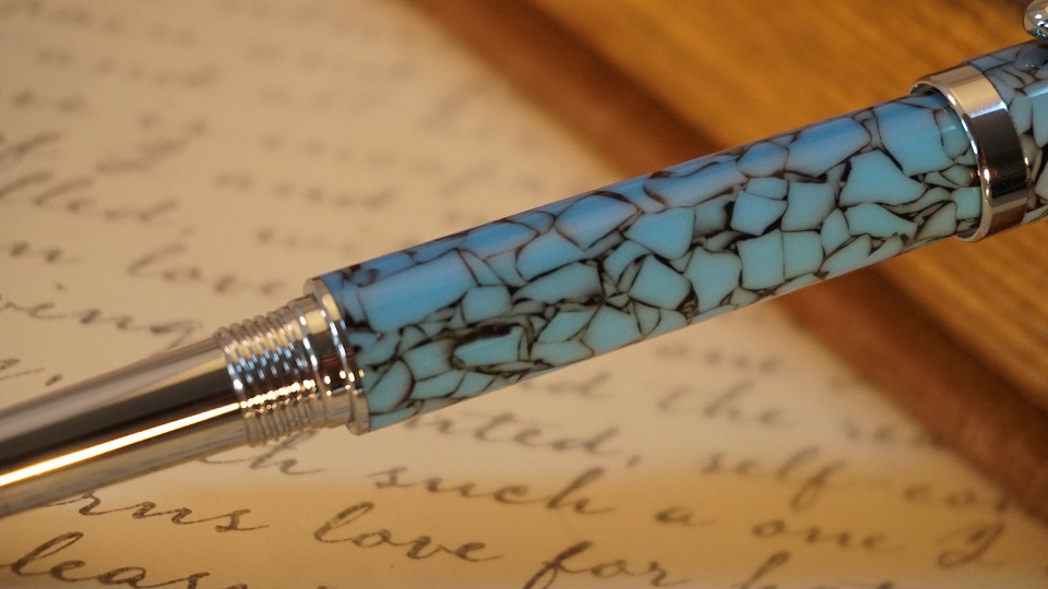

Here are some of the pens I've done since:

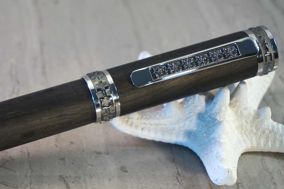

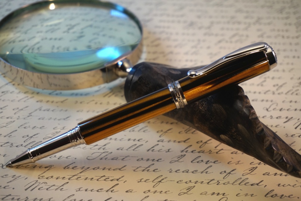

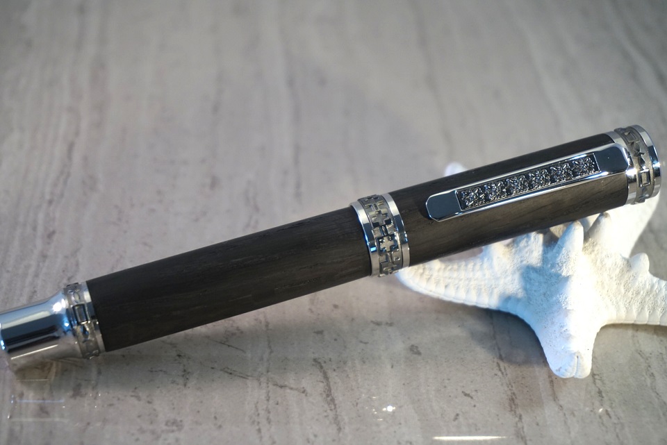

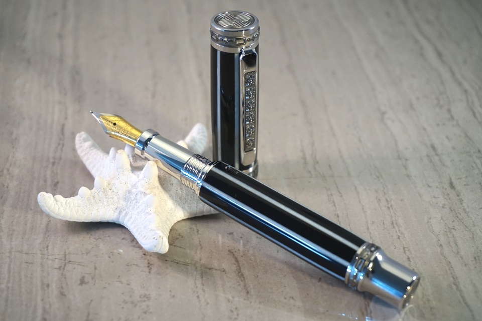

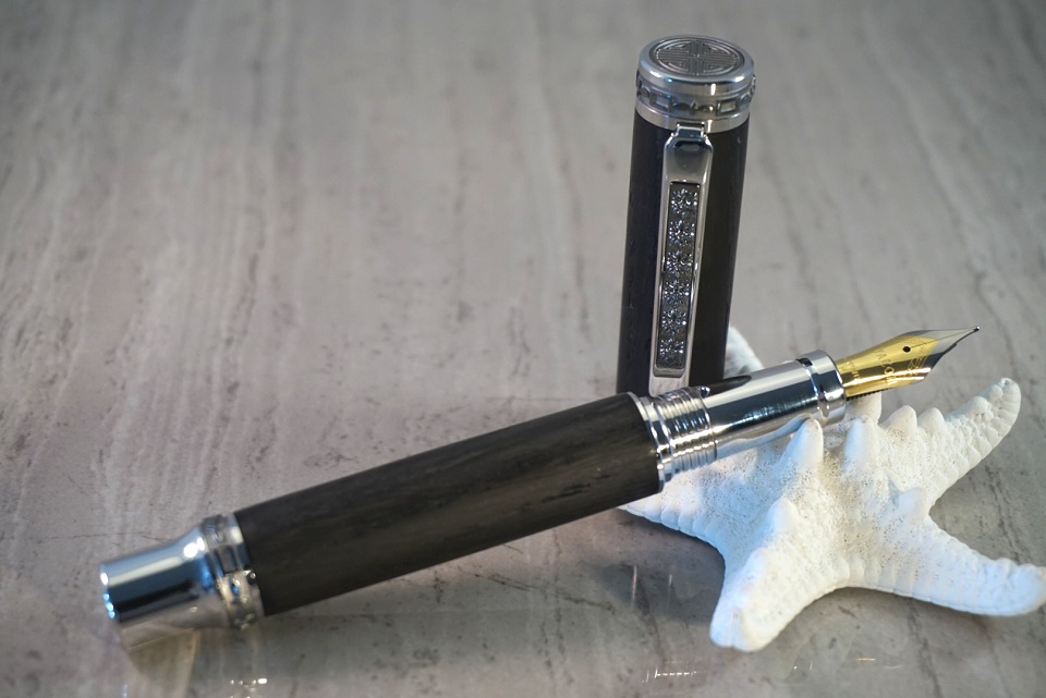

Thanks, the Emperors are favorites of mine as well. One was done in a black resin with pearl white stripes and the other is 7000 year old Russian Bog Oak. I applied thin CA to the bog oak and then sanded it with 400, finishing it with MM. I like a more natural finish with this wood, it gives it some presence.
Would you mind sharing your finishing process for the non-wood pens?
Its funny that you would ask me that as I am kind of transitioning my process. I have, up until now, finished my resins pretty fine with a skew, then use either 400 or 500 grit sandpaper on the lathe, finishing up with the lathe off and sanding across the length of the blanks. Then, I would use MicroMesh, wet, through all the steps, and finish with Stick Fast's medium and fine polishes.
Lately, however, I have replaced the MicroMesh and polish steps with a buffing wheel. I use Tripoli, and with the blanks still mounted to the mandrel, buff them diagonally, in both directions. Then I move to the White Diamond wheel, do the same thing, then finish with buffing along the length of the blanks.
Most of the pens I made in the Gallery shipment were MicroMeshed, while most of the pens after that were buffed on the wheel. I still MicroMesh some materials, I like the way that the fine sandpapers continue to level the material more evenly than the buffing wheel.
