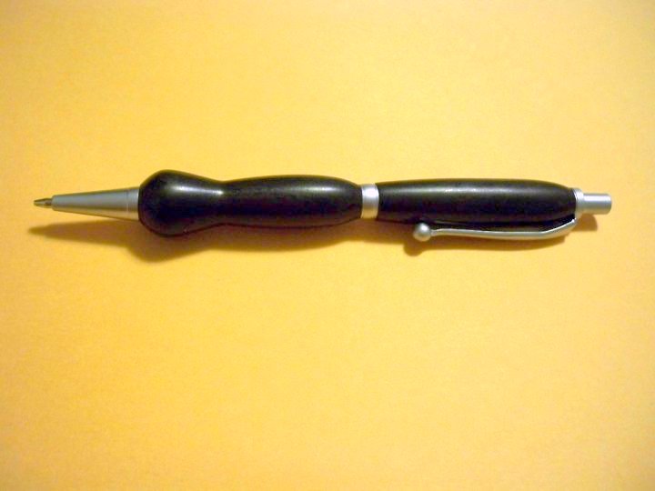

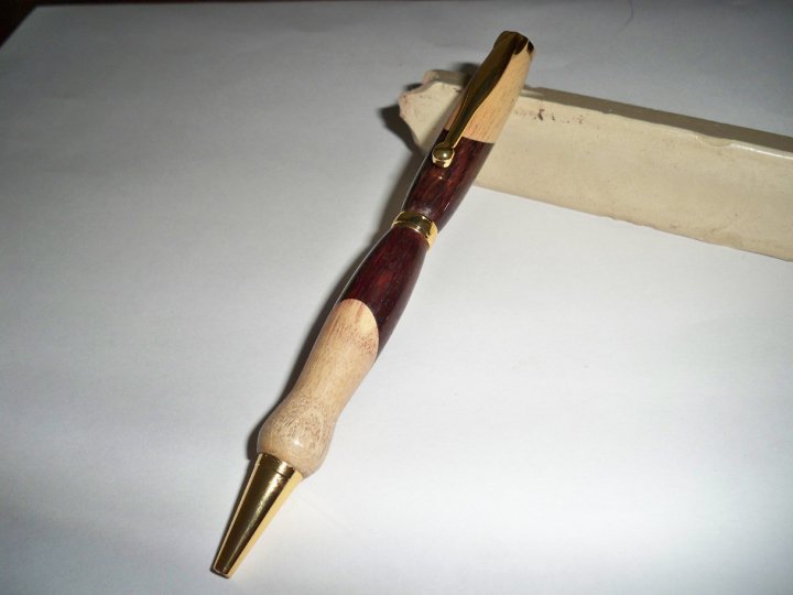

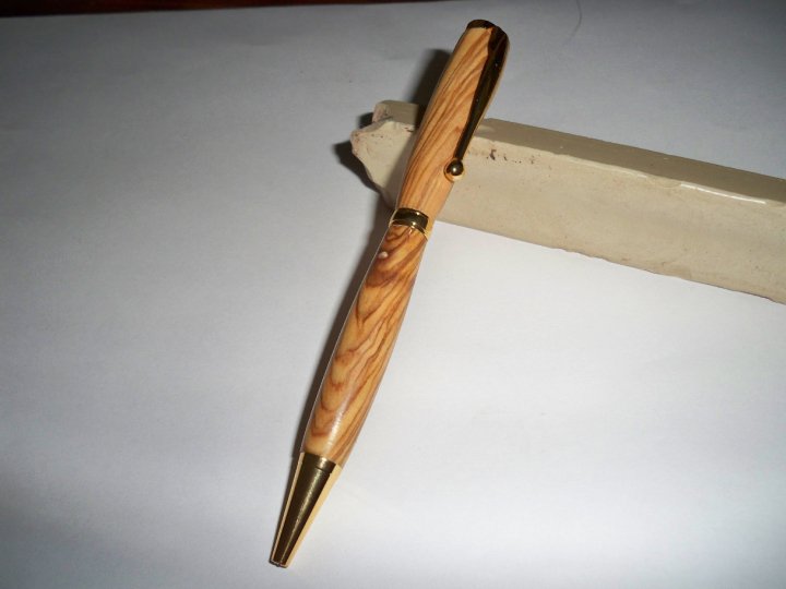

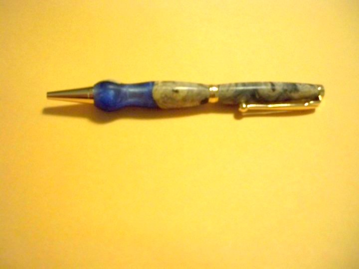

i recently started pen turning and these are some of my favorites that i have made 3 of them in 1 day
i know pretty bad photos but its the best i have for now. i hope you all will like them

I agree with jonathan - beautiful segmenting lines! Very well done. I like how you are experimenting with shapes using basic slimline kits. That is exactly what I did when I first started out. By the way, is the far right pen turned from Olive wood?
Many congratulations on the quality of the construction of your first few pens; excellent work. I look forward to viewing more of your pens. Many thanks for sharing.

thank you all. yes the one on the right is olive wood i like it too but the wood ended up cracking on me so i had to cover it up with the clip

Some nice work there! If your blank cracked when you were pressing the pen together it MAY have been becuase there was glue inside the tube (very common) check closely .... I use some brass brushes meant for cleaning guns but you can also use a small round file. Chamfering the inside of the tubes slightly with a countersink also helps.
I Look Forward to seeing more! :)
