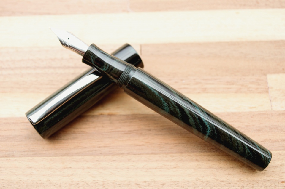

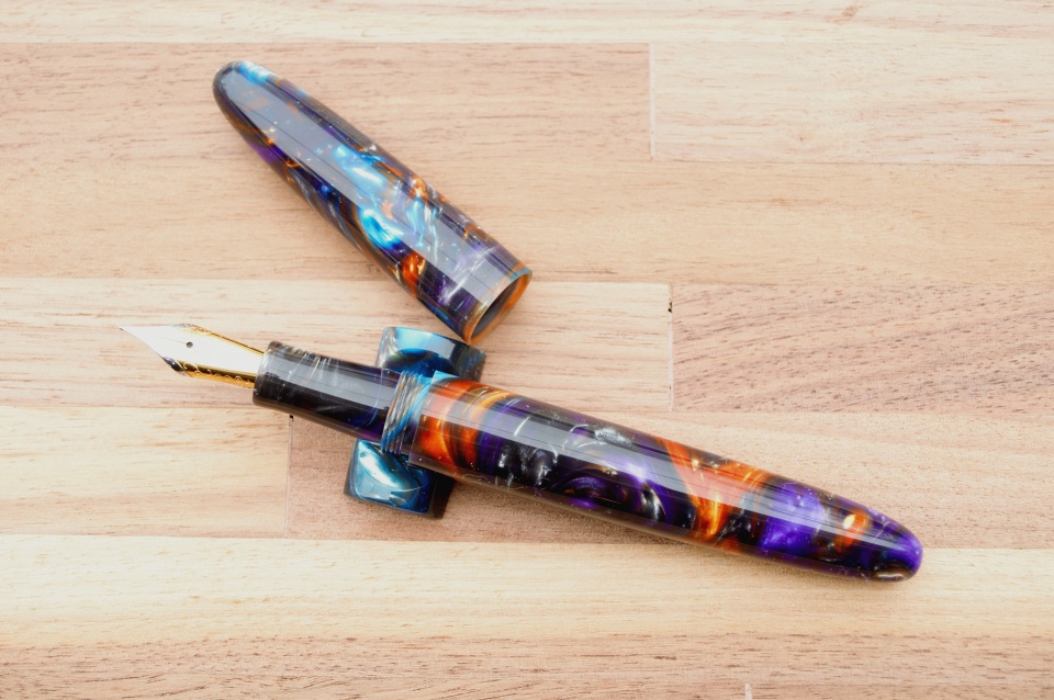

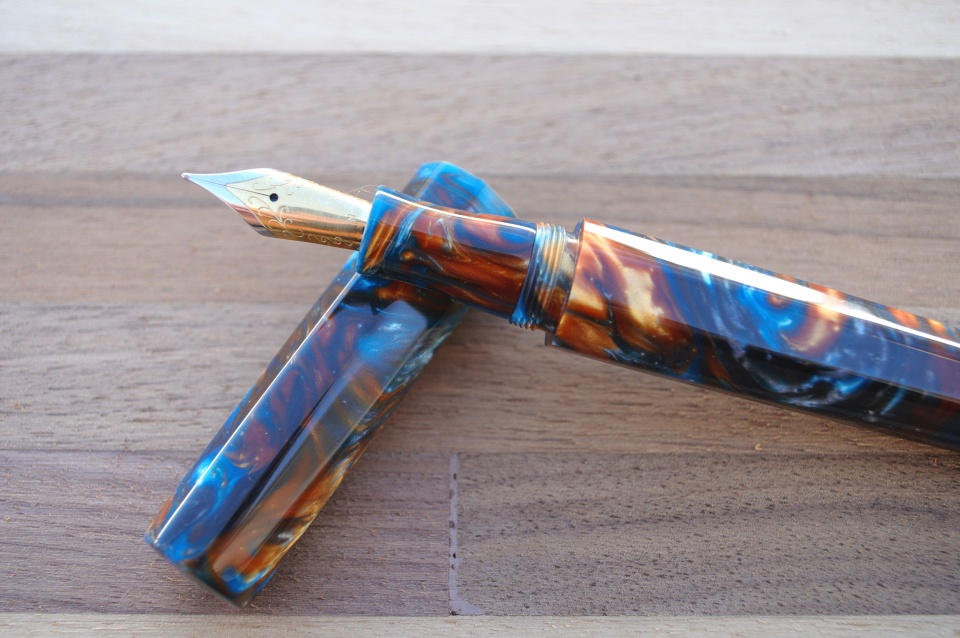

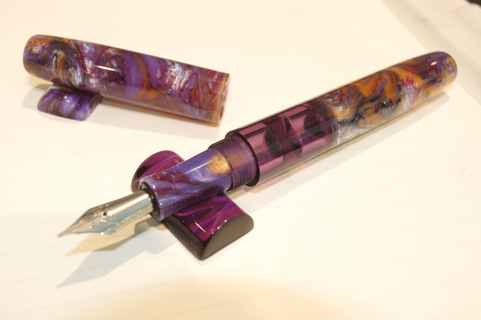

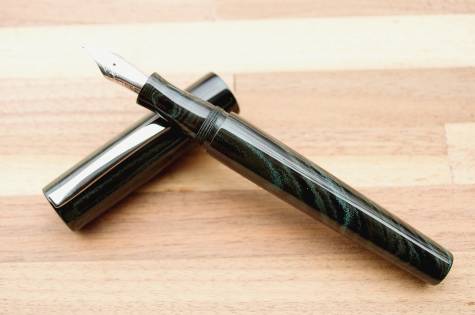

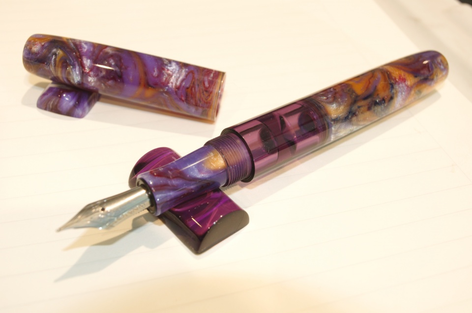

Just wanted to post a few pictures of some commissioned pens recently completed. Having a good number of orders coming in and happy to keep busy in this great hobby!

They are all great but I love 2 & 3. Make me think of deep space. Have you considered getting rid of the sharp drop between the body and threaded portion? It looks like it would be a bit uncomfortable if writing for an extended period.

My favorite is #3. Did you pour that blank your self, or buy it?
Bill
Pen blanks were purchased through various suppliers. The only blank I poured was the transparent purple on the double ended pen. I have only poured colors that were not readily available but I am set up for large pours now. I hope to do more of that this spring and summer and hopefully create some great one off blanks to really make my pens stick out.
Yes I have on specific pens. Often times I leave it up to the customer. I use my Maymont model daily and it has a lip and I have no issues. It's personal preference for sure.
