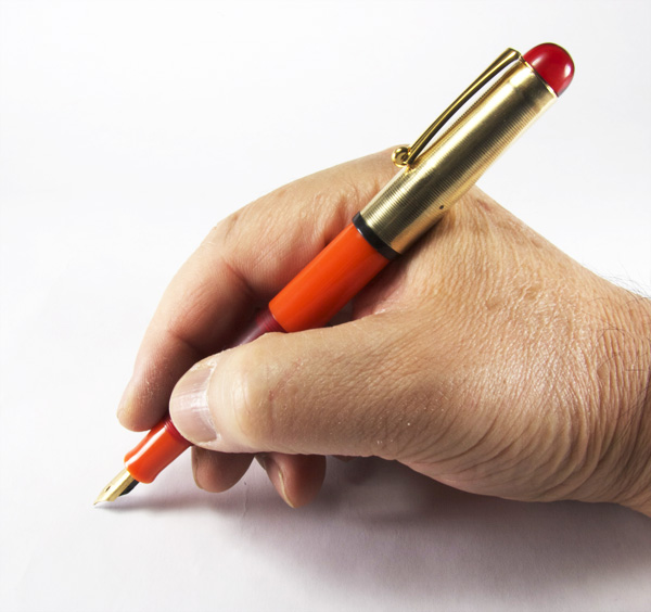

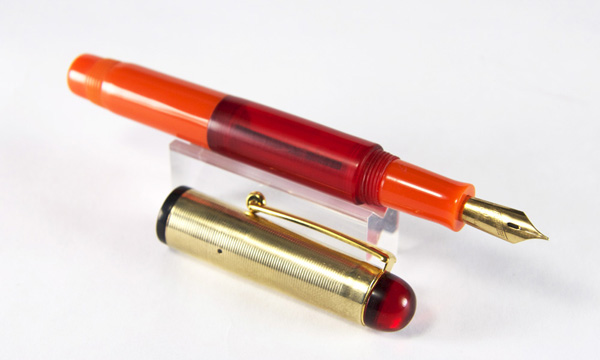

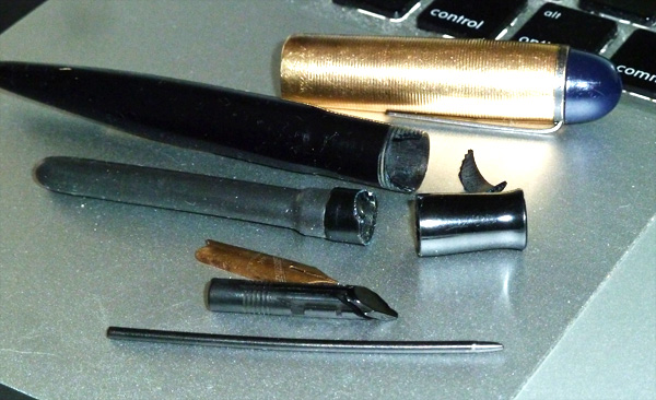

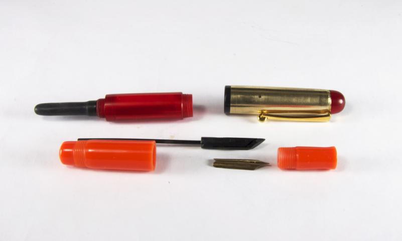

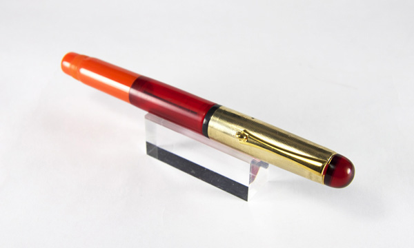

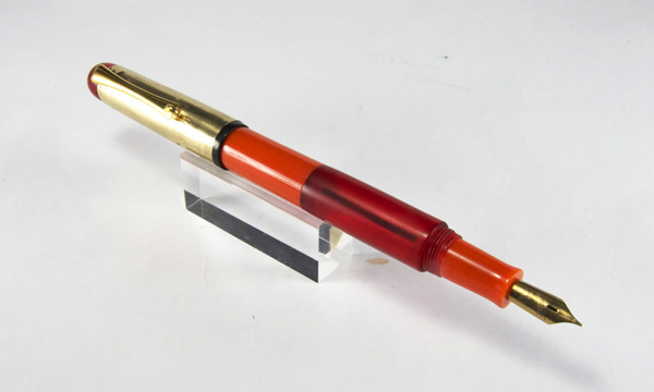

Hi all, I bought vintage Eversharp Skyline at flea market few weeks ago, but It broke off at the section and barrel while I was using. It has a 14k gold nib, gold filled cap and lever filler. I am environment friendly guy so I recycled some of it's parts and made a completely new pen. Lever filler is too much for me so I changed it to bulb filler. It is my first bulb filler and works very well. The Clip was already missing when I bought it so put new clip. Home cast Alumilite for the see-though barrel, finial and inside the cap. free goodie orange Acrylester from woodturningz for the section and bulb cap. I reversed the cap orientation so the 12mm threads can be used. Thank you for looking and as always c&c welcome.

Thank you. Yes, all plastic portion and clip are new. Red see-though Alumilite was a bit soft so it was difficult to polish. I tried to rethreads original plastic (I think it was celluloid) tube inside the cap but failed so I used my Alumilite to replaced it.

Thank you Robert. The breather tube was already there (see the first photo) so as the holes in the feed. So I didn't have to deal with the drilling. It takes 12-13 squeeze to fill the reservoir that hold about 3ml. I could've used larger sac to reduce the squeezing times but I wanted to reuse the original sac. The nib was pretty good originally. It only needed tine alignment.
