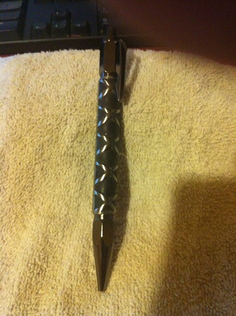

Made this for my brother-in-law he works for a cement company, he is the shop manager and over the trucks. I know the picture is not the best the grandkids broke my camera so had to use iphone. comments welcome

:RockOn::RockOn: Fantastic looking pen. You realy have to be right-on when you drill the rod to make your pattern come out even. What did you fill it in with ? Jim S
Just drilled a 3/8 hole in a piece of #5 (5/8) rebar sanded it down a little to remove the rust, clued the tubes in and put it together. Hardest part was drilling the hole for the tubes.
Used my wood lathe to drill it out.
