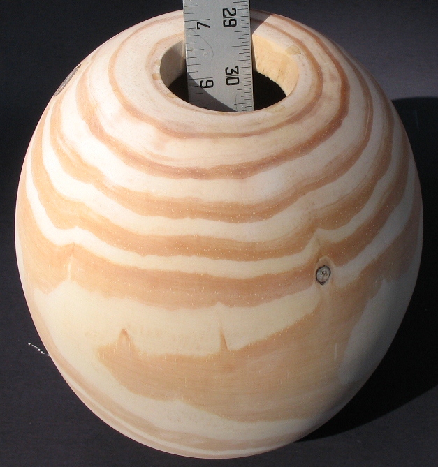

Here is a wet end grain turned Long Leaf Pine Hollow form set off to dry that will eventually have internal PVC threads so can PVC screw on top.

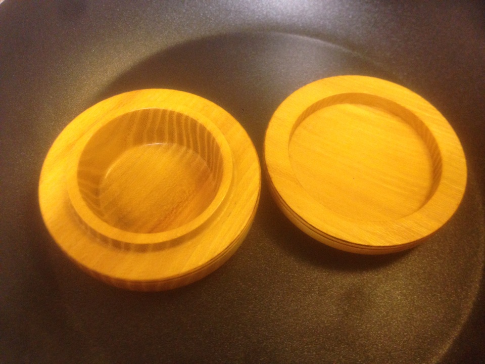

When I turn the boxes I make the lid and bowl from the same piece. I did notice that even a short "potty break" as mentioned would cause cracking. I'm going to need to slow down and start turning and then let them dry some. I was trying to make boxes with tight lids. I'm afraid they will swell to much when shipped down states.

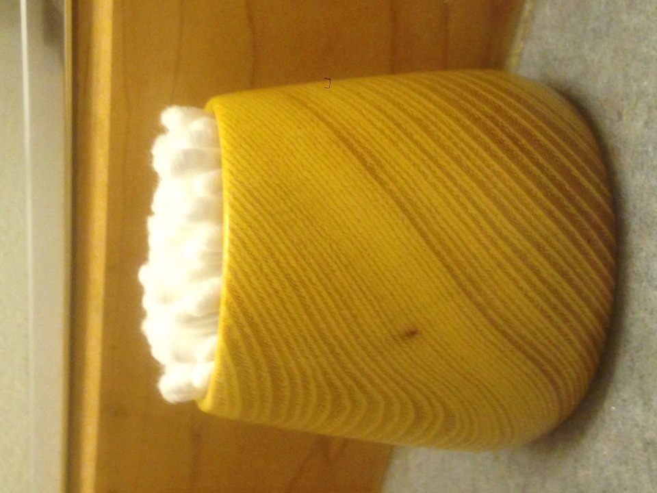

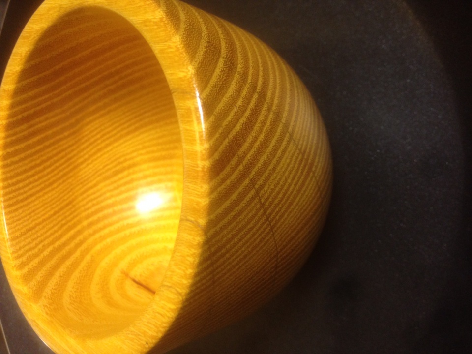

Had to get them off my phone. The box lid only fits in a few orientations any longer. :( Osage Orange from 4x3 blanks. Sealed with Pens Plus.
