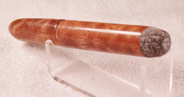

This is a pen I made yesterday, after the thread from wood butcher on writing a tutorial about the subject. I contacted Bill to see if he was going to follow up on his method and put it on the site. I explained the two methods I used to make the ash look real, and that I could possably explain them in a simple thread, if that was all most people were interestd in. And I didn't want to preempt his effort. He said go for it !! The works of the pen are PSI Magnitic Vertex Rollerball, but any pen kit will do, even a Slimline. Although a realy didn't need them, I used the tubes to give the pen more strength. I countersunk the coupler and magnets into the Quilted Sapele blanks. I turned down the faceted end of the coupler so it would fit into a round hole. The nib and the roller ball were the only other parts from the kit I used. By carefully measuring and drilling, I didn't need the spring. The ash on the end was added after I finished the rest of the pen with thick CA, and is a segment of Blackwood added and shaped on the disk sander. You don't want it to be perfectly round. To make the ash look real, I used a rotary tool with a very small ball cutter to roughen up the surface. Next, I painted the end of the pen with a white craft paint. Before the paint dries completely, take a rag and wipe off the high spots until you are satisfied with the results. Excuse the not so pefect fit, I forgot to round over one of the blanks. I have also done this effect on a mini pen formed into a chared branch made out of polymar clay, that I will also post. If this is enough to get you going I will call it a day. If you want a tutorial on how to make this type of pen, let me know. It,s a double closed end pen without a clip, but could be made in a lot of different ways with different kits. Jim S

Overall, NICE. What keeps the cap on? If I may make a suggestion (?) I would drill is super small hole in the area that one would puff on to draw the smoke in, just of course, for adornment. Thanks and be well.....Jan
Jan; Cap is held on by magnets. I went out today and bought a real cigar and box. Needed a band for mine. The one I purchased has no hole in the blunt end, and is cut square on the other. I also found out that the real cigar I bought is about 2 inches longer than the one I made, or about 7 inches by 3/8 inches around. I don't know much about cigars other than they come in different lengths and thicknesses, and have different names for each kind. Maybe someone out there can tell me how they draw the smoke through the sealed end. I have seen people clip the ends off and put them in cigar holders. I don't smoke, so I have no idea. Does anyone know where one could get fancy bands? Jim S

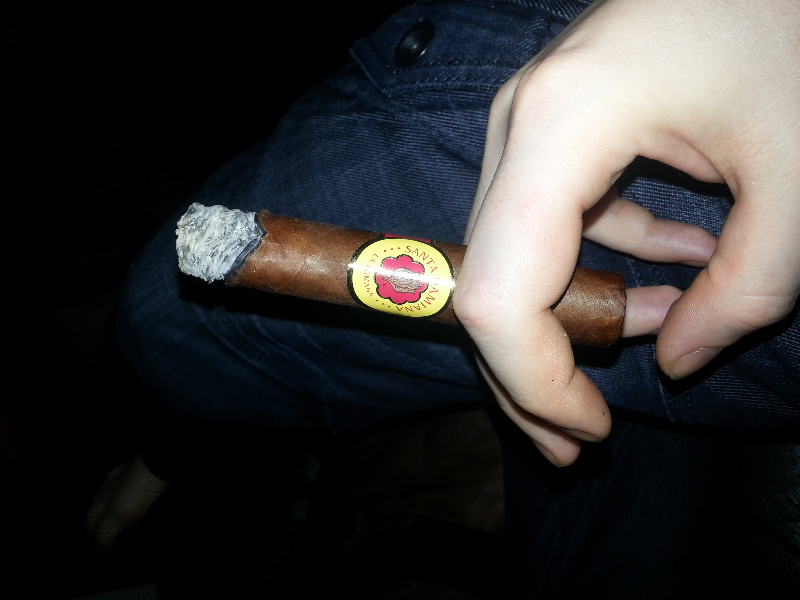

Here is my realistic cigar pen. Its so realistic you can actually smoke it! And tastes fantastic too.... though its missing all the pen components :biggrin:
So are you worried about the white paint wearing off in time?
Not realy, because the white paint is down in the recesses of the tip and will realy never get any direct contact. I guess one could put a clear flat
finish over the end if they choose to. the more contact the tip gets the blacker the Blackwood will get and the contrast will be even better. One thing I noticed on Maxwell Smart 007's photo was how he had an uneven ash and a dark black burn mark on the tobacco leaf. This would realy add a little more realizem to the cigar. Great photo !!! I was thinking of adding either some silver or red Sparkel Dust to the next one to give it a little ember glow. What do you think? Also I think if one could find the right piece of gray Buckeye Burl, it could be used for the ash. Jim S

Ummm... I'm pretty sure that Andrews picture IS a cigar. Thus the realism!

Excellent work on the Sapelle! I hate working with that stuff - it tears, cracks and even with veneer it's hard to get a straight cut with a knife.
:rolleyes: Jan; That hole you were talking about got me to thinking. I know I had seen that somewhere before. I searched through the library tonight and found it. I think it will make turning this pen and any other closed end pen much easier for some beginning pen turners. It's a tutorial by Mick ( michr, He lives in the Wilderness someplace, and has no last name, so I can't give him full credit ) on how to turn " closed end pens on a regular pen mandrel ". I usualy leave a little extra on the end of my blank and drill a little pilot hole to put my live center in and turn between centers or with a 4 jaw chuck on the square end. Who knew !!! Jim S
Here is a case where gloss on the pen does not look good. Dull the pen down and get more a realistic look. Thanks for showing.
You are correct John!! Dull would be more realistic. However, with the GG quilted Sapele, I just couldn't let that grain go to waste. Sorry !! But that is a very good point taken. Jim S
