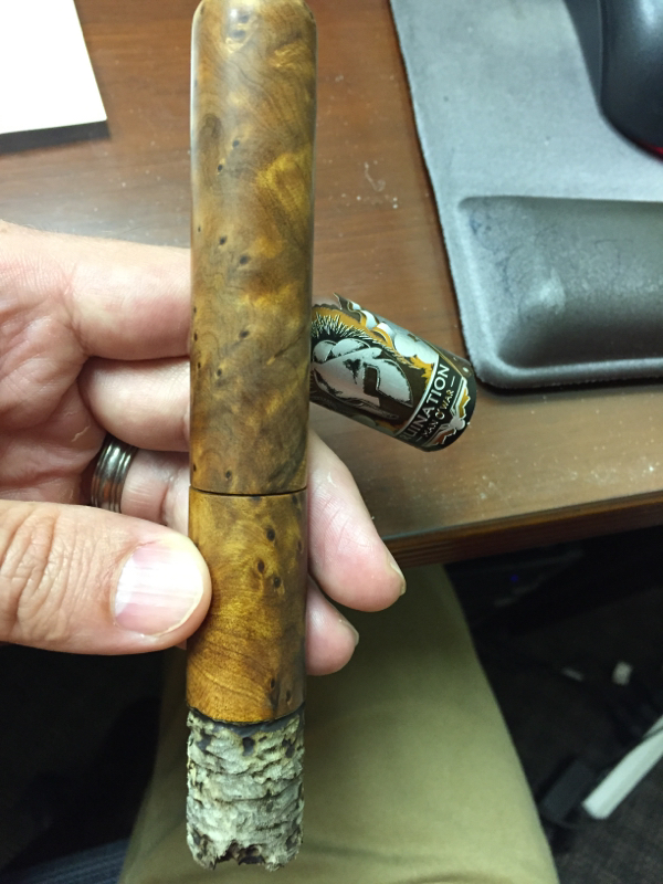

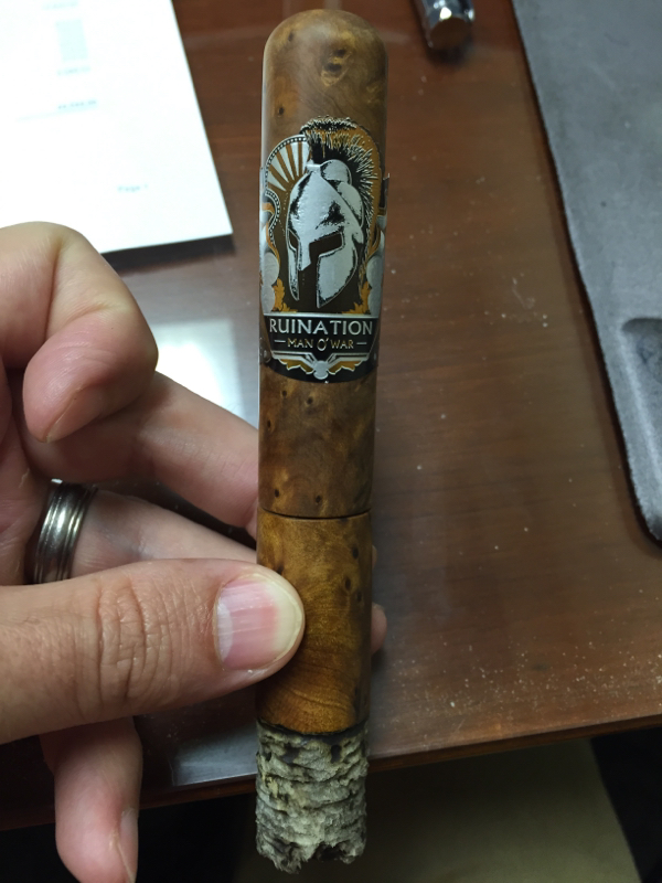

I agree on non permanent band. The last one I made I have the band completely loose. That way it can be customized for someone's favorite cigar or a band with significance to them. Just used adhesive where the band could connect to itself at the right size needed for a slip fit.
